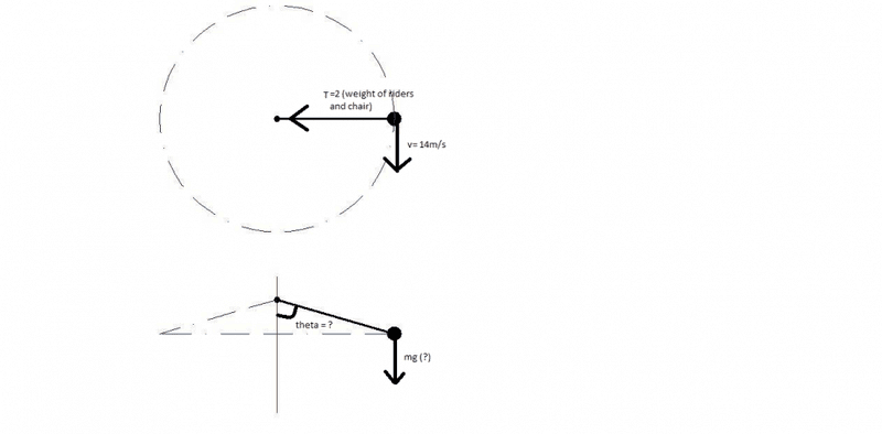

The County Fair Swing carries the mass of riders and chairs in a circular path in a horizontal plane while suspended by cables or chains. Let's assume that:
Each chair with riders is supported by a single cable
The tension in the cable equals 2 x the total weight riders and chair
The speed of the center of mass at the end of the cable is 10 m/s.
Determine the radius of the circular path in meters.Selected Answer:
50
T=mv^2/r
T=mv^2/r
so r=10^2/2
100/2=50
50=r

t=tension. and I have drawn diagrams, and i just, tried v^2/2g, and it was also incorrect, am i using the right Equations?

It is always much easier to sort these types of problem out if there is something to look at .
Mark in the forces which you think are acting and any other information you consider relevant .
Let's see what your free body diagram looks like
does this help
Hi Sherlock:
Your diagram is a good start, but you need to add the horizontal and vertical components of the tension.
does this help
Yes. OK If T is the tension, what are its components in the x and y directions, in terms of the angle the rope makes with the horizontal?
Likes SherlockLCooper
I want to say
(T Cos(theta)i, T sin(theta)j) where the y component would be T Sin(theta)=mg..?
so t/mg= 2, so sine (0) =0, so it is in the horizontal plane, the alternative T Cos(0)= T*1= T.
so all the velocity would be in the horizontal plane?
Hi Sherlock:
If you visualize the right triangle, you are given the facts regarding the vertical component, and the tension is along the hypotenuse. You don't need the angle to calculate the horizontal component. You can use the Pythagorean theorem.

If T = 2mg, then ##2mg \sin\theta=mg##, then what is ##\sin \theta## and what is ##\theta##?
Pity T is missing in the side view in post #13...
30 degrees!
30 degrees!
Good. Now let's see your force balance in the horizontal direction. There is only one force acting in the horizontal direction.
(2mg cos 30)/m=a=v^2/r
m cancels so v^2/2gcos30=r
Likes Chestermiller
(100)/(2)(9.8)((3^(1/2))/2)=5.89 meters
ill try this and let you know! Thank you so much!
it worked!
