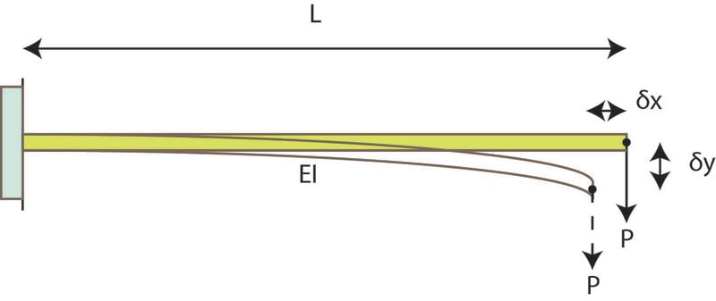

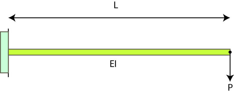

Hello you clever people,
I'm having a bit of a logical problem with the deflection of a simple uniform cantilever beam loaded with a downward force on the free end.
My intuition is that the beam would do something like this:
But most literature, and my mechanics of solids course at uni says this happens:
We're using Castigliano's theorem and so far we get that δy=PL3/3EI , but I'm convinced that there should be a horizontal component to the deflection.
If so,
Firstly: Is this horizontal deflection factored into the above derivation and if so how would one calculate the horizontal deflection? Could you just use the parameterization of the parabolic nature of the deflection?
or I guess you could work it out for from the slope?
Secondly: If the horizontal deflection isn't factored in, how would you derive it? I would imagine that the elastic strain due to the vertical deflection would have an effect on the horizontal deflection and vice versa until you reach your equilibrium point for the structure.
I hope that I'm just being silly and WAY overthinking this, please excuse if this is a trivial/stupid question.
P.S. please excuse my horrid drawings, and their size - couldn't figure out how to change that.
Euler-Bernoulli beam theory makes certain simplifying assumptions about the deflected behavior of a beam:
1. the slopes along the beam are small.
2. plane cross-sections remain plane after deflecting.
3. the region where there is zero bending stress is called the neutral plane or the neutral axis. This is due to the fact that, using the cantilever shown, the top fibres are in tension and the bottom fibers are in compression, so there must be a line somewhere in between, where the bending stress = 0.
http://en.wikipedia.org/wiki/Euler–Bernoulli_beam_theory
If there is no axial stress, there is no change in the length of the neutral plane.
There are more advanced beam theories available, which account for the effects of different loads and which don't use the simplifying assumptions of the Euler-Bernoulli beam. There are different large-deflection theories available, so that the more general relationship between the radius of curvature of the beam and the bending moment is utilized. For short or very deep beams, there are theories which account for shear deflection of the beam cross section.
http://en.wikipedia.org/wiki/Timoshenko_beam_theory
Unless one specifically needs to account for any of these exotic conditions, the regular Euler beam theory gives good results sufficient for engineering accuracy with a minimum amount of calculation. The other, more general, beam theories require much more calculation effort.
You are right in theory, but in practice it doesn't matter unless the "beam" is bent through a large angle - for example something more like a leaf spring than a structural beam.
You can estimate how much difference it makes with the crude assumption that the beam remains straight and pivots at the fixed end. If the length is ##L## and the deflection is ##D##, by Pythagoras's theorem the horizontal distance changes to ##\sqrt{L^2 - D^2}## which is approximately $$L(1 - \frac{D^2}{2L^2}).$$
If the deflection is 1% of the length of the beam, the length would only change by about 0.005% .
Even if the beam deflects by 10% of its length, the length only changes by about 0.5%.

Thanks both of you for your useful answers! Glad I'm not as psychotic as the peers I've discussed this with think I am.
I wonder if there is not some more elegant relationship that one could come up with than the Timoshenko derivation but that isn't as assumptive as the Pythagorean result.
I get what you're saying in terms of practicality, but to me it doesn't seem like a thing one should just gloss over. I mean I don't think many of my peers even fully acknowledge the assumptions we've been making, and since the course I'm taking (mechanics of solids II) is in the Mechanical/Electro-Mechanical stream - those assumptions could have some ill follow-throughs in the stuff that we end up designing.
As with learning most topics, you have to take it one step at a time.
The simplest assumption (which you are learning) is that the structure has small strains and small displacements. That ignores everything except the linear terms in the math. The shortening of the beam is a quadratic term, as my simple estimate showed.
The next simplest assumption is small strains but the complete structure can have large rotations (like the leaf spring example). That means you can still have a linear relationship between stress and strain.
The most general assumption is that the strains can be large, which in practice also means the material behavior is nonlinear.
The small strain small displacement assumptions are useful for many real world engineering situations, and they are the only ones where you can do much with hand calculations. Once you go beyond that, you need to use computer models to solve anything except very idealized problems.
