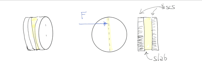

So the situation is that a ball of mass ##m## and radius ##r## is at rest on a horizontal surface. There is friction between the ball and the surface. The ball receives a horizontal impulse at some height ##h## above the surface (##r<h<2r##) and starts moving.
One possible question is: "find ##h## such that the ball rolls without sliding". This is discussed e.g. in thread 1 and thread 2.
After looking at these threads and some more sources I'd consider the angular momentum of the ball wrt an axis that lies on the surface and is perpendicular to the impulse (i.e. to the ball velocity).
This choice gets rid of the contribution of the friction to the rotational impulse on the ball. Friction in principle still affects the overall impulse. However, as suggested in thread 2, one assumes that the impulse is sudden, i.e. it lasts for a very short time. Therefore the impulse of the friction is negligible when compared to the impulse of the cue stick.
Hence, taking into account that the initial momentum is ##\vec p_0=0##, we have ##\vec J = \vec p_1=m \vec v_1##.
Since the impulse is horizontal and at an heigth ##h## above the table, and since the initial angular momentum is ##\vec L_0=0##, we have that
##J h = L_1##.
After the impulse, the ball moves with velocity ##v_1## and rotates about its center with angular velocity ##\omega_1##. Its angular momentum wrt the chosen axis is ##L_1=I \omega_1 + m v r_1##.
If we want the ball to roll without sliding, it should be ##\omega_1 r = v_1##, so that ##L=(1+\kappa) m v_1 r## where ##\kappa =2/5## for a homogeneous ball. Therefore we get ##(1+\kappa) m v_1 r=m v_1 h##, which gives ##h=(1+\kappa) r## (or ##\kappa r## above the center).
##J h = L_1##.
Be careful here. [itex] h [/itex] is the distance of the cue-stick (i.e., impulse) above the table. But if you want to find the resultant angular momentum, you'd be more interested in the height difference between the cue-stick (i.e., impulse) and the center of the ball. So, I think there should be an [itex] r [/itex] thrown in there somewhere.
not really... I am considering an axis of rotation on the table. The correct lever arm for the force is ##h##, right?
I stand corrected. Although it's not the approach I would have taken myself, particularly when solving for the situation with finite forces and static friction, etc., taking moments around a point on the table is valid.
