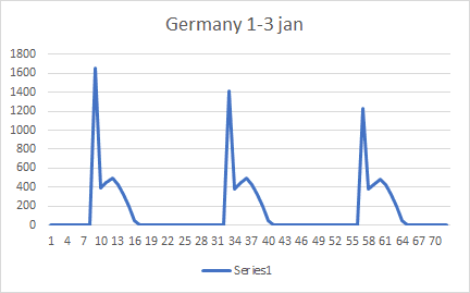

I have a question pertaining to solar angles required to calculate a solar panel's hourly generation over one year. Total solar irradiance on a tilted surface equals the sum of the direct, diffuse and reflected component. In my case, reflection is assumed zero and the diffuse and direct horizontal components have been calculated.
The problem is the conversion of the direct horizontal component to its tilted counterpart. For this, I calculate the hourly ratio Rb (cosine of incidence over cosine of zenith). The horizontal component times Rb equals the direct tilted component.
The problem however is that this ratio Rb becomes incredibly large at times due to the zenith angle's cosine being small enough with respect to the corresponding incidence cosine.
This results in an hourly global tilted irradiance (Wh/m2) as such:
Such peaks are just not realistic and I can't seem to find a solution to this problem. This issue occurs nearly every day for all areas. Does anyone have an explanation as to what I'm missing?

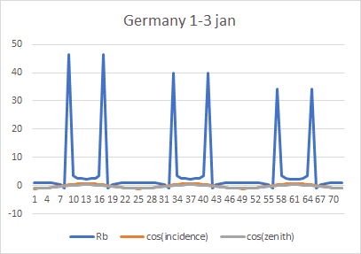

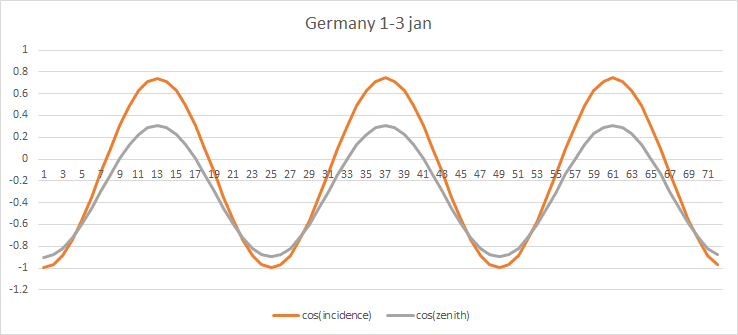

All these angles have been calculated using the, as you put it, massive amount of sources on the web. Now, the calculated Rb reaches infinity at 2 moments per day as thetaZ, the sun's zenith angle is 90° at 2 points during the day. As an example, below is a figure showing both cosines for the first 3 days for a location in Germany:
As you can see, the cosine of the zenith angle passes the zero mark at 2 moments each day, meaning the Rb ratio reaches infinity. This means that any beam horizontal irradiance is bloated to an infinite amount of beam tilted irradiance. This in turn causes massive incident radiation peaks at sunrise and sunset. Therefore I believe I'm doing something wrong. However I can't seem to find a great deal about this ratio or any figures showing these angles and cosines, so I resorted to the good people of the PhysicsForums.

I looked at your graphs at the top, with those pairs of peaks, and the peaks occur around sunrise and sunset when the sun is only grazing the panel. That apparent magnification factor is only relevant when there is virtually no area of panel receiving sunlight. If you multiply your Rb by the cos of the incidence angle, what do you get? (along the lines of 0 times ∞)

I have ben looking in more detail at the longer of the two papers. Rb is just a bit of maths and I think it just tells you that a tilted panel can do a lot better than a horizontal panel when the horizontal panel is picking up very little. The factor of 50 doesn't mean that you will get a lot of Power out; it just means that you will get more than a very little at sunrise and sunset if the panel is tilted a bit.
