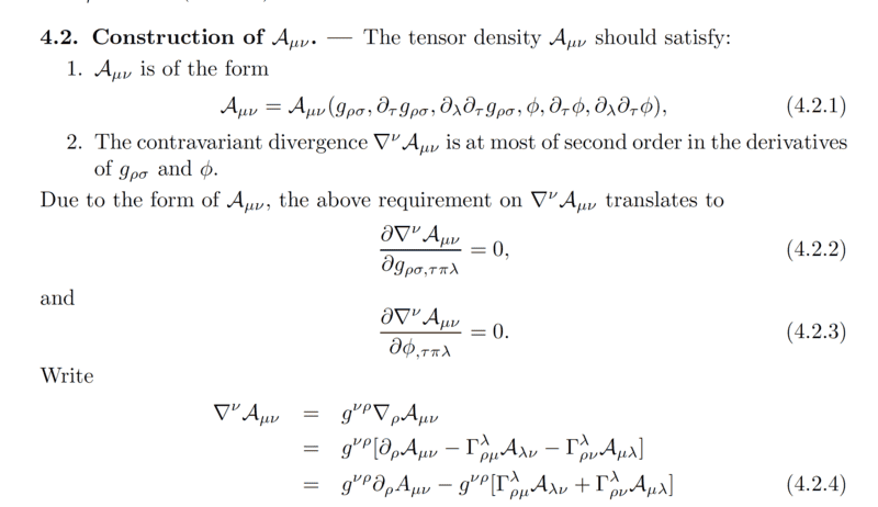

In my exploration of tensor calculus within a specific theoretical framework-potentially related to Horndeski theory or another complex field theory-I have encountered a significant computational issue involving the higher-order derivatives of the metric tensor, ##g_{\rho \sigma}##.
  1. Core Equation:I am examining the following equation:
    ## \frac{\partial \mathcal{A}_{\mu \nu}}{\partial g_{\rho \sigma, \tau \pi \lambda}} \frac{\partial g_{\rho \sigma, \tau \pi \lambda}}{\partial g_{\rho^{\prime} \sigma^{\prime}, \tau^{\prime} \pi^{\prime} \lambda^{\prime}}} = \frac{\partial \mathcal{A}_{\mu \nu}}{\partial g_{\rho \sigma, \tau \pi}} \frac{\partial g_{\rho \sigma, \tau \pi \lambda}}{\partial g_{\rho^{\prime} \sigma^{\prime}, \tau^{\prime} \pi^{\prime} \lambda^{\prime}}}##
  2. Assumptions and Context:The assumption that third-order derivatives of ##g_{\rho \sigma}## are zero is crucial in this framework. This assumption has direct implications for how the derivatives in my calculations are evaluated.
  3. Problem Identified:The term:
    ## \frac{\partial g_{\rho \sigma, \tau \pi \lambda}}{\partial g_{\rho^{\prime} \sigma^{\prime}, \tau^{\prime} \pi^{\prime} \lambda^{\prime}}}##
    acts like a delta function, being 1 when the indices match. However, the term:
    ## \frac{\partial \mathcal{A}_{\mu \nu}}{\partial g_{\rho \sigma, \tau \pi \lambda}}##
    is zero because all third-order derivatives of ##g_{\rho \sigma}## are assumed to be zero.
  4. Mathematical Concern:Typically, having a zero numerator wouldn't be problematic, but in this case, since the calculations require non-zero values for correct progression, having a zero value in these derivatives leads to a division by zero in subsequent calculations, effectively rendering the result as undefined or infinite. This represents a significant challenge to the consistency and applicability of the theoretical model.
  5. Conclusion:The essence of the issue lies in the presence of a zero denominator, leading to an infinite or undefined quantity. This issue may necessitate a reevaluation of the assumptions or the mathematical techniques employed in my study.

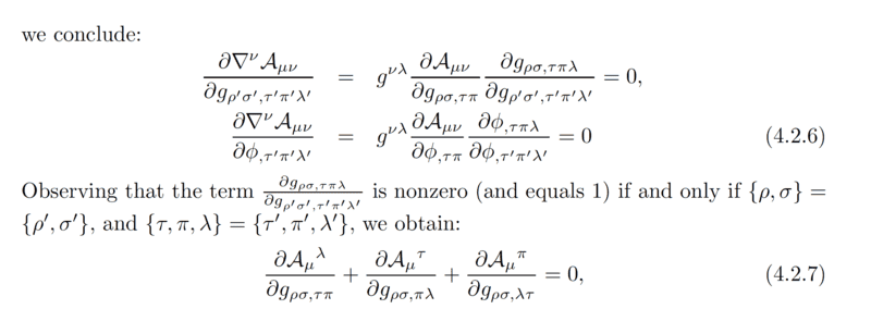

my issue is on (4.2.6) where indice ##\lambda^{\prime}## disappears on the denominator.
Where did you get that from? You need to give a reference.

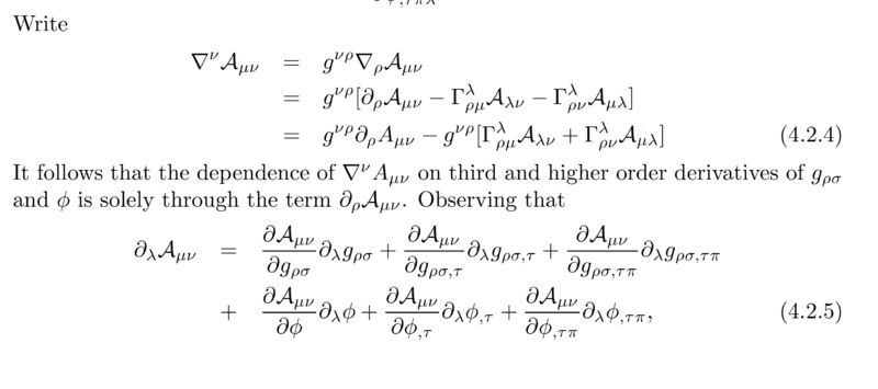

Sorry, I didn't give you the definition of the tenseur ##A_{\mu\nu}## wiht all its dependances :
Actually, the contravariant index ##\lambda^{\prime}## appears on both sides of eq.(4.2.6), so it doesn't "disappear". I think what you're really asking is: how is that equation derived? Here is my take. To minimize the clutter of indices, I consider here the second equation in (4.2.6) that involves ##\phi## and its derivatives, but the first equation follows the same logic. First write:$$\frac{\partial\nabla^{\nu}A_{\mu\nu}}{\partial\phi_{,\tau^{\prime}\pi^{\prime}\lambda^{\prime}}}=g^{\nu\lambda}\frac{\partial\left(\partial_{\lambda}A_{\mu\nu}\right)}{\partial\phi_{,\tau^{\prime}\pi^{\prime}\lambda^{\prime}}}\tag{1}$$where the covariant- is replaced by the partial-derivative since the Christoffel connection has no dependence on ##\phi##. Now since ##A_{\mu\nu}\equiv A_{\mu\nu}\left(\phi,\partial_{\tau}\phi,\partial_{\pi}\partial_{\tau}\phi\right)##, we have:$$dA_{\mu\nu}=\frac{\partial A_{\mu\nu}}{\partial\phi}d\phi+\frac{\partial A_{\mu\nu}}{\partial\phi_{,\tau}}d\left(\phi_{,\tau}\right)+\frac{\partial A_{\mu\nu}}{\partial\phi_{,\tau\pi}}d\left(\phi_{,\tau\pi}\right)$$which implies:$$\partial_{\lambda}A_{\mu\nu}=\frac{\partial A_{\mu\nu}}{\partial\phi}\phi_{,\lambda}+\frac{\partial A_{\mu\nu}}{\partial\phi_{,\tau}}\phi_{,\tau\lambda}+\frac{\partial A_{\mu\nu}}{\partial\phi_{,\tau\pi}}\phi_{,\tau\pi\lambda}\tag{2}$$Only the last term on the right survives from eq.(2) when that equation is inserted into (1), resulting in the equation in your reference:$$\frac{\partial\nabla^{\nu}A_{\mu\nu}}{\partial\phi_{,\tau^{\prime}\pi^{\prime}\lambda^{\prime}}}=g^{\nu\lambda}\frac{\partial}{\partial\phi_{,\tau^{\prime}\pi^{\prime}\lambda^{\prime}}}\left(\frac{\partial A_{\mu\nu}}{\partial\phi_{,\tau\pi}}\phi_{,\tau\pi\lambda}\right)=g^{\nu\lambda}\frac{\partial A_{\mu\nu}}{\partial\phi_{,\tau\pi}}\frac{\partial\phi_{,\tau\pi\lambda}}{\partial\phi_{,\tau^{\prime}\pi^{\prime}\lambda^{\prime}}}\tag{4.2.6}$$
