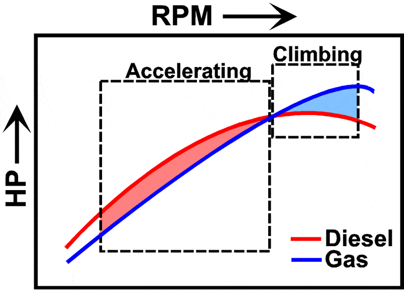

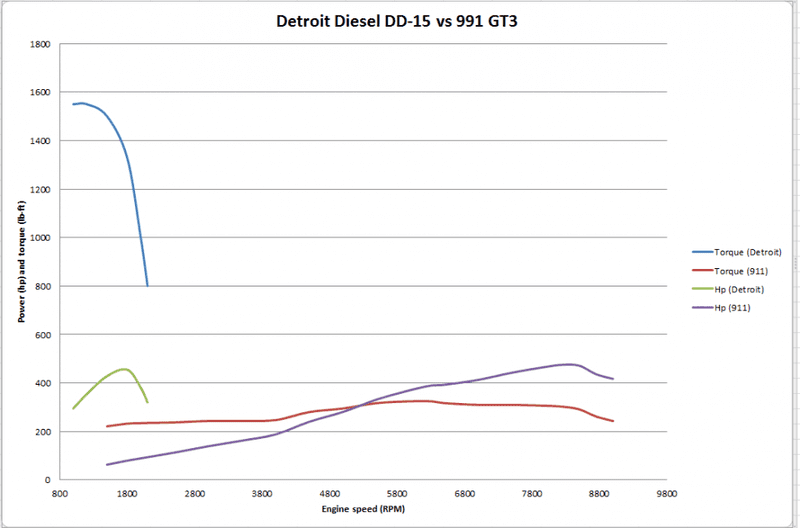

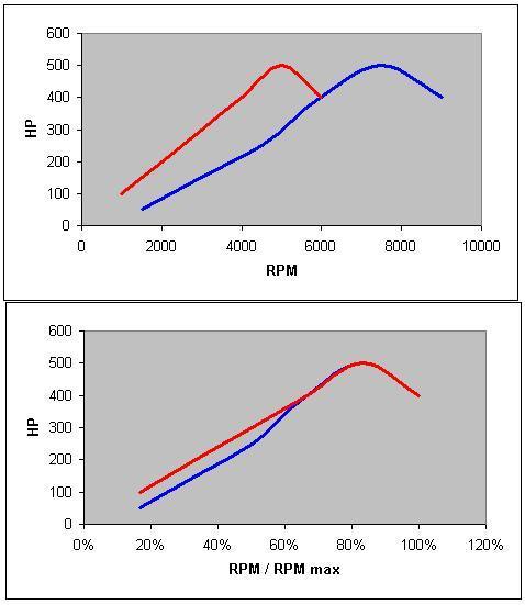

I got it, thanks. So what is it about having the HP in the lower range like a diesel that makes it much easier to maintain the HP ?
If you take a diesel that is 300 HP at 1800 RPM and a gas engine 300 HP at 6000 RPM how would you make a gas engine pull 80,0000 pounds ? I came to the conclusion you would need a air shift transmission like a F1 car that shifts constantly but how many gears would it need to be ?
You see a 238 HP diesel can pull 70 000 pounds to 67 MPH, can a 6000 RPM 238 HP gas engine do that and how would it have to be set up, this is hypothetical and not practical. Just looking for a easy way to explain so people get it. HP can be a funny thing.
Thanks for breaking it down.
Well, diesel rigs used to have 15 gears; that's enough for any rig. It's simply that while the diesel is running happily at 1800 RPM, the gas engine is running 6000 RPM for the same performance and rapidly destroying itself. No mystery which is preferred.
It seems the diesel is able to maintain HP better because it does it earlier, as a gas engine starts dropping RPM it loses a lot of power because it has to spin up way more to make it. Some how or another this equates to the diesel being able to be pull under load better.
Take like I said, how would you make a 238 HP gas engine spinning at 6000 RPM pull and maintain HP like the Mack 238 HP that only needs a 5 speed gearbox ?
Is that Mack 5 speed an automatic?
Thanks insightful your a great help, 5 stick.
That is the thing, a gas motor to pull like the diesels needs a Hi Stall converter Auto so it engages when the RPM are Reved up more on the engine so it has power to do the job, with a stick or Low stall converter Auto they have big problems because they engage at a lower RPM and the HP is not there.
Diesel's according to what I have heard work much better with a stick for this reason because when you drop the clutch the RPM's do not drop lower as much so you keep more HP to build more from.

The difference between high- and low-rpm engines is usually the power available at lower rpms. For example, look at the following fictitious power curves:
Both engines have the same maximum power output, but once you synchronize the engines' rpm with the help of an appropriate gear ratio (2nd figure), you find out that the red one has more power in the lower band. This is really important when you are in a stop-and-go situation (like a truck in traffic). The blue one is usually done by a small engine where the upper band is maximized at the expense of the lower band (which often affects fuel consumption efficiency as well). For a race car, the weight saving is of concern and the car rarely stops, so the engine is kept in the higher rpm range all the time.

Moretorque said:
What about this, when you have Motors of the same HP but the one with lower RPM power band and more torque does that not allow it to pull terminal velocity a little faster under heavy load because when you shift it is able to build RPM back up faster because it has more torque ? I understand now why the F 1 cars would benefit majorly from a air shifter so RPM's do not drop to maintain HP because like I said a big V8 can regroup better ?
If you can keep the motor in its powerband at all times, there is no difference. If I have two engines, one which makes 200lb-ft at 5252 rpm (and thus, 200hp), and another which makes 100lb-ft at 10504 rpm (therefore also 200hp), and if they weigh the same, and have the same overall torque curve shape (scaled appropriately to their respective peak power and RPM), and then I give them different gear ratios by a factor of 2, they will perform identically.
