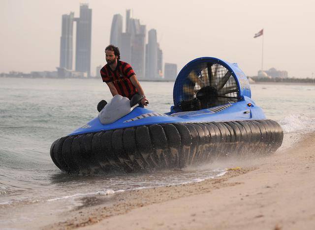

We need a picture to help this discussion, IMO... :biggrin:
https://images.boats.com/resize/wp/2/files/2015/04/hov-pod-hovercraft.jpeg

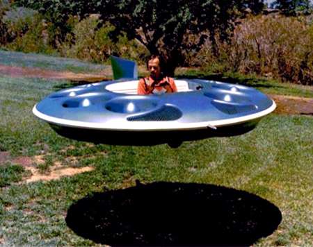

Klystron said:
:kiss: no skirt design :oldcool: ultra-cool pic
Agree but that's not what I would call a hovercraft. It's more of a ground-effect helicopter and I wonder how much fuel it would eat up, compared with a hovercraft with real skirts and what sort of load it could carry. (Hopefully, me on one occasion)
