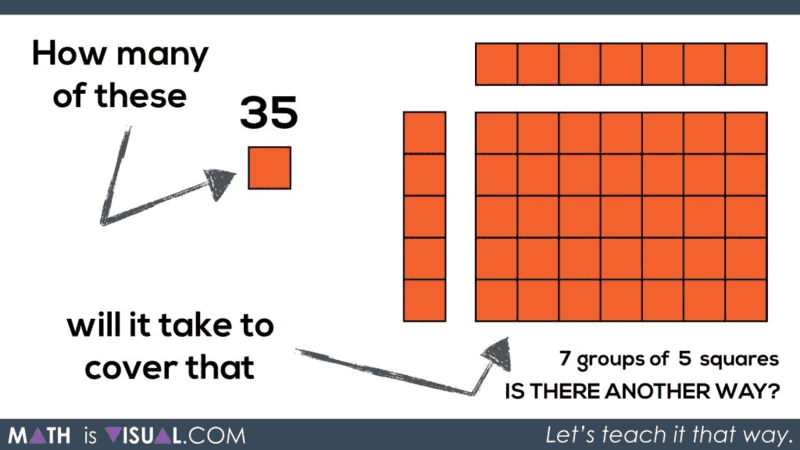

For whole numbers, it means how many "times" you have a quantity. So if I count a quantity of "A things" "6 times", I get 6*A of the things. Think about a 2-d rectangle made up of a whole number of smaller rectangles. There are "A" rectangles laid out in a row, and "6" rows of those A rectangles...
EDIT -- similar to images like this one:
https://mathisvisual.com/wp-content...ompts.129-7-groups-of-5-squares-1024x576.jpeg
Likes topsquark
