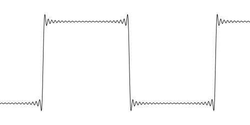

The exact shape would depend on how the loudspeaker was designed, but one possibility is that it might look something like this:
This helped a lot, thanks a lot AlephZero for the big response and DrGreg for the wave pic. :smile:
A square wave is a composite of an infinite number of sine waves (see Fourier Analysis) and actual physical systems cannot reproduce the higher frequency components, which is why it ends up looking something like what DrGreg just drew.
