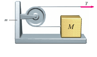

Sure. Here's the latest one.
A 10k.0-kg block rests on a 5.0kg bracket, as shown below. The 5kg bracket sits on a frictionless surface, the coefficients of friction between the 10kg block and the bracket on which it rests are u_s = 0.40 and u_k = 0.30.
a) what is the maximum force F that can be applied if the 10kg block is not to slide on the bracket?
b) What is the corresponding acceleration of the 5kg bracket?
What had me stuck forever is the fact that we were taught to do a FBD of each, and to find the maximum force that can be applied without the block slipping you would do a F_staticmax - F_tension = 0 and solve. But here, we are "supposed" to just be okay with setting F_Staticmax - F_Tension = ma, implying that the actual force of static friction is somehow greater than the tension creating it. I can't get over the fact that because the box is not moving relative to the bracket, you should find F_staticmax by solving u_s * mg = F, then applying that force to the entire system of mblock+mbracket to find the acceleration, but instead you "go backwards" and the acceleration dictates the force.
It's not very intuitive. Nothing in the textbook went over a scenario like this, and even my teacher couldn't explain it properly (He drew the FBDs wrong as well, there's supposed to be a 2F force on the bottom bracket but I I would have never been able to figure this out myself). I still don't understand what exactly the force is that is making up for the difference in f_staticmax and the tension since the only other force I can think of having anything to do with the block is the reaction pair of the f_staticmax from the bracket)
F_staticmax - F_tension = 0 corresponds to the block not accelerating in the lab frame. If the block does not slide, it will accelerate, together with the bracket, and you have to take that into account.
You can solve this in the frame of the bracket, but then you get an additional "fictional" force from the non-inertial frame, with the same conclusion.
What I don't understand is why you can't just set F_staticmax - F_tension = 0 and solve for F_tension, then apply that force to the whole system with F = (M1+M2)*a
What I don't understand is why the fstatic max is cut "short" when you examine the systems acceleration. We're lookign for the max force youre able to apply without it budging, so why would the force that will cause the box to budge off the bracket be any different than the force applied to the system (Since taut rope, T = F).

Put your working down *step by step* and we might see where you are going wrong. Here's my step by step reasoning, which may be wrong - I'm rusty on this stuff!
M - mass block
m - mass bracket
1. Applying the Force F by the pulley is exactly the same as applying the force F by pushing the 10kg block.
2. F = usgM = 0.4 * 10 * 10 = 40N
3. F = (m+M)a, therefore a = 40/15 = 2.667 ms-2
OK - that might be rubbish, but others should easily be able to point out where I'm going wrong(!)

i know how to do the problem and what you have to do, I just don't see why you the maximum force that accelerates the system without the block slipping is different than the force it takes to budge the block
See post 7. There is a net force on the block, so you cannot assume the forces on it sum to zero.
martinlematre said:
I just don't see why ... the maximum force that accelerates the system without the block slipping is different than the force it takes to budge the block
Neither do I. Isn't it the same force?
Isn't that just the force F in the left horizontal direction? (The only other force on block is the force of gravity downward: Mg)
This is the only horizontal force on the block beside friction, sure, but friction plus tension don't add up to zero because we know the block is accelerating.
Th original problem statement says nothing about tension in the rope! Can't we just assume the rope transmits all the force F?
What do you mean with "all the force"?
Tension in the rope is F, sure.
