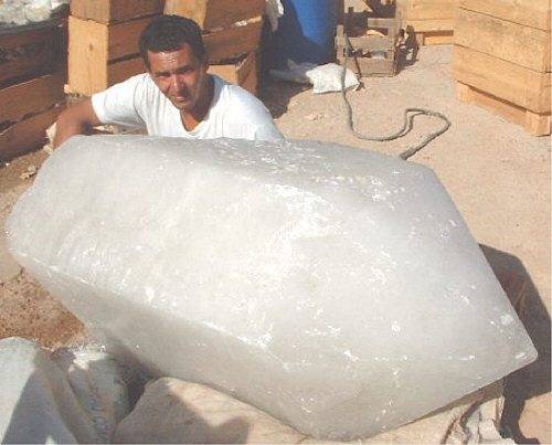

Hello eptheta.Try googling "the giant crystal project".I'm sure you will find it interesting.
Oh my god! Its quartz !
The giant crystal project is all about minerals mined from caves etc. I was wondering about laboratory(or in my case kitchen) grown crystals...

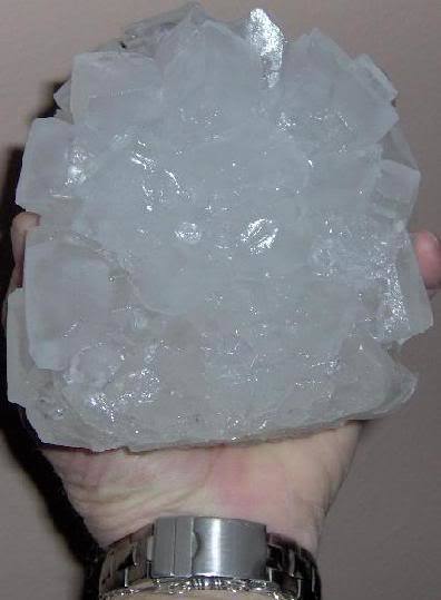

Here is a pic of a cane sugar crystal cluster I grew in about 9-10 months. I changed the solution and container several times. I donated it to the local High School Science Teacher, the kids probably ate it. :)

Wow, that's big !

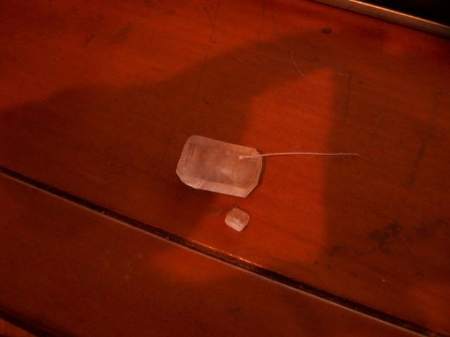

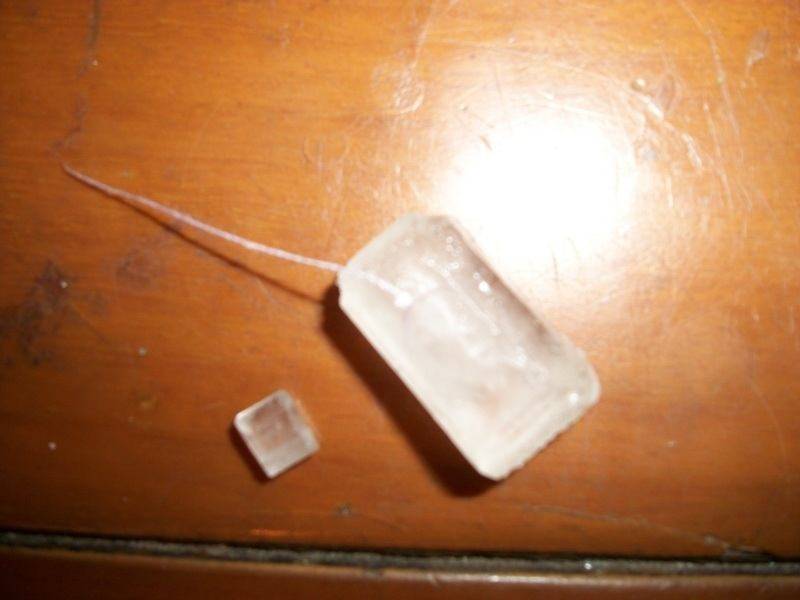

Tell me, did you initially plan to grow it uniformly (i.e in its standard crystal configuration) but it went haywire? Or was it your intention to grow a crystal cluster ?
I've tried to grow sucrose crystals too but after a certain point(size/volume) they stopped growing and clusters began to emerge. (I tried only twice and they came out approximately the same size, but then again, two isn't really a very large number to draw conclusions from).
I've attached 2 pictures. You can judge the size based on the standard crystal or the shadow of my finger.
Any particular methods you used ? Or was it just boil, saturate, cool, grow, start over ?
Also kitchen or lab ?

@ eptheta. Beautiful crystals, I don't know how to grow only one. My formal education stopped at the 9th grade so I'm a self taught scientist. I prepared a supersaturated solution of cane sugar and carbon filtered tap water in a quart mason jar with a piece of cotton Venetian Blinds cord suspended from a pencil and covered it loosely with Saran Wrap so it could evaporate slowly. I kept in the back of a kitchen cabinet in the dark undisturbed. Every couple of months I prepared a new solution in a larger container, let it cool to almost room temperature, pulled the cluster out and swiftly placed it in the new solution/container. It turned into a cluster right off the bat, totally covering the cord. 7 years later I still have a gallon freezer bag with all the smaller crystals that formed on the sides of the containers. It sucks I'm diabetic, I love rock candy. :)

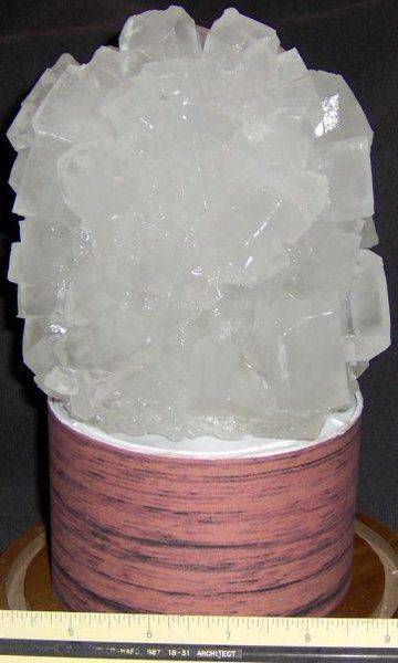

Here is another picture with a scale so you can see the size. It was setting on a 4" PVC coupling with cheap shelf paper over it. ;)
