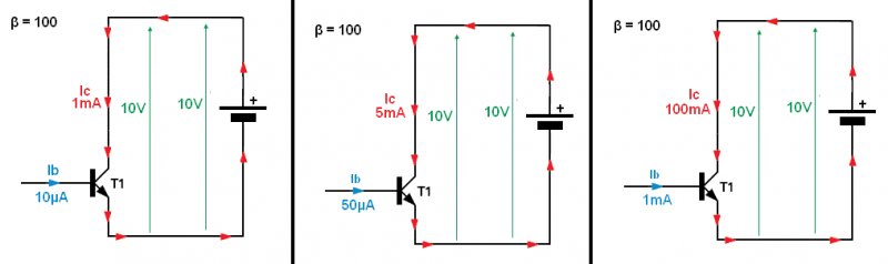

Well I prefer a water analogy.
The BJT work very similarly to the tap water valve.
A water valve is always used as a device to control the flow of water. Similarly, always think of a bipolar transistor as a device used to control electric current flow by assistance of a base current. See this picture
http://images.elektroda.net/94_1250754403.png

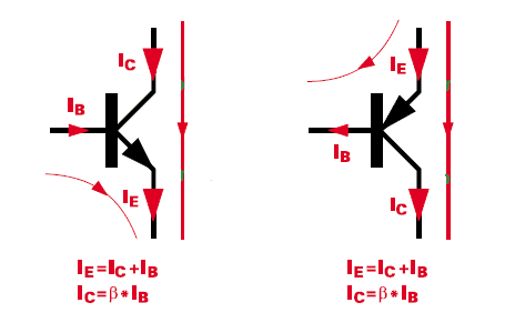

If base current is flowing the BJT is ON and the collector current is BETA (β or Hfe) times larger than the base current (Ic = β*Ib).
And Ic = β *Ib and Ie = Ib + Ic is a basic principle of a transistor "action".
Of Course this "gain" current comes from power supply not from transistor them self. Transistor can only control the amount of collector current (Ic) that power supply supplies.
The emitter current is always equal to Ib + Ic. But because the beta value is large we can ignore the base current and say that Ie = Ic.
For example if β = 100 and Ib = 10μA we have Ic = 100 * 10μA = 1mA and Ie = Ib + Ic = 1.01mA
So we don't do the big mistake/error if we ignore the Ib current and say that Ie = Ic = 1mA

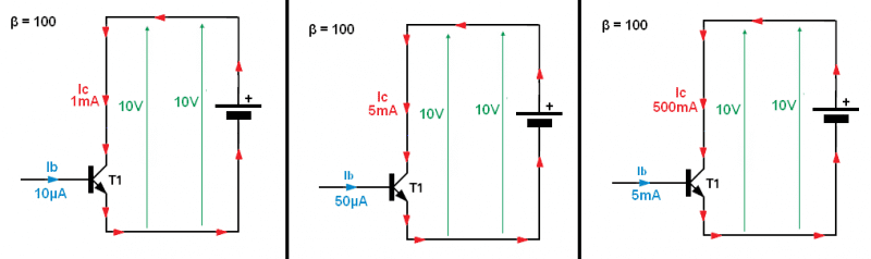

Suwandy said:
Also, i feel off when it said transistor act as "amplifier" (amplifying base current). The highest current value in NPN transistor is on Emitter. Meanwhile, the common usage is to put Load Output on collector. Why collector? Why not emitter if the function is to amplify current which has the highest value for current?
Sometime we use emitter as a output. But notice that the emitter voltage (output voltage) is always Vbe ≈ 0.6V lower the the base voltage (input voltage). See some examples:
As you can see the current gain is not everything, some times we need a voltage gain also. And in this case we must use collector as a output.
Or if we want to use transistor as a switch it is better to use collector as a output because of a lower voltage drop across transistor.

On this part, the example pictures showed that Ve keep getting bigger as Ib increasing, which i think that was a voltage gain on Emitter part. Wouldn't the voltage gain of Ve always bigger than output on Collector? Also, which voltage drop is lower? i still don't get this part
But how can we say about the gain if emitter voltage is always Vbe lower then the base voltage ?
In first fig Vb = 2V and Ve = 1.4V; in the middle Vb = 6V and Ve = 5.4V, and last fig Vb = 10.5V and Ve = 9.9V
Why this voltage is lower? Well because base-emitter junction is nothing more than a ordinary diode. And Vbe is a forward voltage drop.
Also notice that in this circuit the emitter voltage follow the base voltage minus Vbe voltage.
And this is why we called this circuit emitter follower or voltage follower

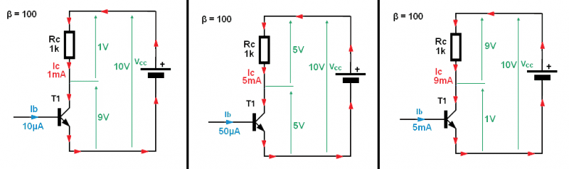

Transistor without any resistor is nothing more then a base current controlled collector current source Ic = β * Ib .
As you can see we have a "current gain", but with no voltage gain.
What we can do about that ? Let as try to add Rc resistor and see what we get.
Now we give Rc resistor very important task. His job will be to covert Ic current into voltage.
Rc will act just like a current to voltage converter thanks to Ohms law Vrc = Ic*Rc
Finally we have a voltage gain. Our amplified voltage is of-course taken between collector and emitter (Vce).
Also notice that we can change voltage gain by changing Rc resistor value.
The larger the Rc resistor value the larger the voltage gain. Why you may ask? Well because now we need smaller change in Ic current to get the same change in Vce. For example for Rc = 1k we need change in Ic current from 0A to 10mA to change Vce voltage from 10V to 0V. But now if we increase Rc resistor value from 1k to 2kΩ we need ΔIc = 5mA to get the same change in Vce.
So we need smaller change in input voltage to get the same output voltage. So this means that our amplifier has larger voltage gain. I hope you understand this and the important role which lies on Rc resistor.

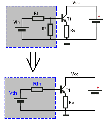

But there is also a simpler way to solve this circuit by using thevenin's theorem.
We can replace the voltage divider (this gray rectangle) with his Thevenin's equivalent circuit
Vth = Vcc * R2/(R1+R2)
Rth = R1||R2 = (R1*R2)/(R1+R2)
And now we can solve for Ib
Vth - Ib*Rth - Vbe - Ie*Re = 0
And we also know that
Ie = Ib*(β +1)
Or
Ib = Ie/(β +1)
so we end up with
Vth - Ie/(β +1)*Rth - Vbe - Ie*Re = 0
[tex]\Large Ie = \frac{Vth - Vbe}{\frac{Rth}{\beta +1} +Re}[/tex]
And this is the end.
PS. Notice that Ie current is 41.9mA not 4.19mA
Ve = 4.19V ----> Ie = 4.19V/100ohm = 41.9mA
Sorry for stupid mistake

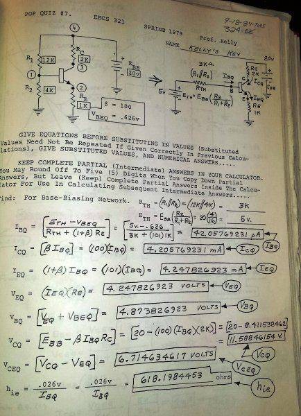

Here is a pop quiz answer key by Dr. Ruben Kelly.
Note you can get all of your equations by Inspection. This works on more difficult circuits as well including feedback. Old material, but still works well.
Dr. Kelly was pretty picky on us kids using our calculators properly. Rounding numbers would make you fail class.
Last time I looked his lecture notes were available on Amazon.
Likes Suwandy
This picture is interesting, the Ibq function is same as previous equation explained by Jony130.
Does it mean this Ibq function is a common knowledge that can be applied anywhere (w/o feedback)?
Yes, for all BJT circuit which contain a voltage divider and Re resistor.
