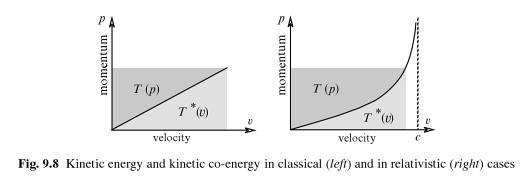

In The Mathematical Structure of Classical and Relativistic Physics book page:263
For relativistic cases the two equations give different results, but I don't understand why.
As I said if it is about mass increasing, then both of the equations have mass parameters. Because p=mv.
I am asking how can (1/2)mv^2 and p^2/2m be different? What is the reason?
In the relativistic case, ##p=\gamma mv##, and ##KE=(\gamma-1)mc^2##, where ##\gamma=1/\sqrt{1-(v/c)^2}##. If you Taylor expand the expression for ##\gamma## you can recover the Newtonian expressions where v<<c. But you can see that you would not expect your relationship to hold.
Basically, the equality you are expecting is only ever approximate. When you are at low velocity, the error in that approximation is not important.

Because both of them are approximations valid (and equal) only in the low-velocity limit.

The problem is that ##p\simeq mv## and ##KE\simeq mv^2/2##. So ##KE\simeq p^2/2m##. The approximation gets worse the faster you go.
As Orodruin noted, the m term in these equations does not change with velocity. Modern physics has largely dropped the concept of mass varying with velocity, primarily because of the confusion it causes in cases like this. The only thing changing in this case is v (and hence ##\gamma##). And since the full relativistic equations do not have the same dependence on v that the Newtonian ones, your co-energy expression is only approximate.

I think this made me confused because, the books about this topic give relativistic case for energy-coenergy equations. So I thought energy and co-energy is equal for classical mechanics but for relativity, only the "energy" function is valid but co-energy gives wrong result. But this is not true either, because in relativistic case neither energy nor co-energy equation is valid. Relativistic energy equation is different from them.
So why in world, do they give "relativistic case" for these energy-coenergy equations. It makes only confusion.

As opposed to the nonrelativistic case, the relativistic case shows that the two notions are actually distinct.
And this distinction leads to an example where the Lagrangian is not always equal to the kinetic-energy minus the potential energy.

Look on the next page of Tonti's Mathematical Structure of Classical and Relativistic Physics p.264.
The "kinetic" term of the relativistic lagrangian of a free particle is not its "relativistic kinetic energy" ##(\gamma-1)mc^2##.
