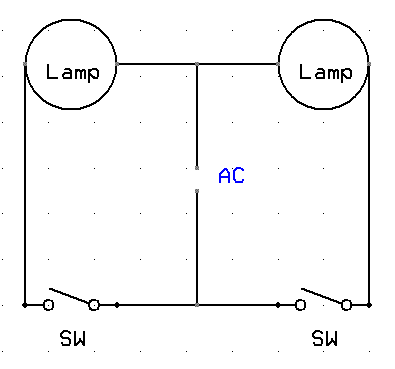

So my teacher was showing us this circuit he made in class today, and he won't tell us how it works. This is the picture of the circuit:
http://img517.imageshack.us/img517/7576/trickcircuit1tb.jpg"
Its an AC circuit, one wire going through two switches, and then two light bulbs. He showed us, with both switches closed, both lights went on, as normal. Then he opened both switches, and neither light bulb lit up, as expected. Next he opened the right switch, and closed the left, the left light bulb went on, but not the right. How was this possible?? This also worked vise versa. He won't tell us what he put in the circuit to do this. Does anyone know how the circuit was able to do this, is it a trick? ( I thought it might have something to do with the light bulbs, since both were frosted and you couldn't see inside them, also he wouldn't let us touch the circuit after he demonstrated). He did say there was something that we couldn't see that was important. What was it?
because the circuit was really wired like this:
no, there was no wire hidden in the board, the hidden thing is in the switches or bulb.
Its because current needs a complete path to flow. IF the switch is open that means there is not a complete path or as some say an open circuit (infinite resistance). Please refer to the circuit diagram in the previous post. Try to trace the current path in both loops. Start from the AC source then trace to either side of the circuit. If the switch is closed, that means current can flow so you contiunue to trace. But if it is open, then you can't trace on that side of the circuit anymore. The key is start at a point and trace back to that same point. If that is accomplised, then you have a complete path and the lamp would light.
yes I know what a circuit is, but I am saying there is no hidden wire outside the circuit I first drew. There is something hidden in either the switches or the bulb, nothing outside that. I came up with this...

That circut is wrong. In that circuit the bulbs will only light when both switches are closed and non will l ight when just one is open. That is what I was trying to explan in my previous reply about a complete path for the current to flow. The circuit that mugsby has is correct.
look closer... its basically two different circuits, the red wire connects to the cirst switch, goes in the base of the second switch ( not connected) goes under the base of the light bulb( not connected) goes to the second light bulb ( CONNECTS HERE!) and back around (thats 1 complete circuit) The BLUE wire is basically another circuit, goes under base of 1st switch, connects to second switch, connects to left light bulb, goes under base of right light bulb, and back to make full circuit. (2 complete circuits, left swich controlling left bulb, right switch controlling right bulb. Get it now?

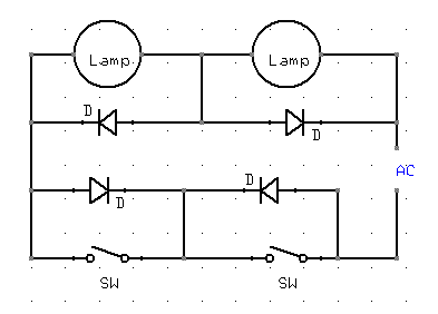

I'm not sold on it. I think the OP has the schematic done correctly in the first post since I have seen this trick in the past. The OP says the teacher implied that there is something else hidden in the circuit. There are diodes hidden in the switch bases and light sockets. The diodes in the light sockets point towards each other and the diodes in the switches point away from each other, or the other way around. Either will work. Next time the trick is done look closely at the bulbs. You MAY be able to notice a flicker since each bulb is running on only half of an AC cycle.
average super nova, congratz, you are exactly right! Too bad you didnt post it this morning when I needed it :cry: Yes the teacher told us how it was done, and your explanation nailed it. O well, next time you will see my posts earlier :-p
I'm still missing a piece of the puzzle. I get the diode thing, but in the OP's first diagram, there is still no closed circuit until both switches are closed.
Then you don't really 'GET' the diode thing. Redraw his circuit, and then draw the diodes in how I described them in my previous post. You will then see how the circuit is indeed closed for half of the AC cycle.

Dave, the first diagram IS correct. We are told in the first post that the teacher implied there was something hidden in order to make the circuit behave the way it did. Obviously if whatever it is that is hidden were revealed by being drawn on the schematic then it wouldn't be much of a puzzle would it? Please tell us why you think it won't work even with diodes.

So, you're saying that, at first appearance, it looks like the OP's diagram in post#1, but underneath things, it actually looks like Grandma's post #5 PLUS the diodes.
No Dave. I'm saying it is like the first post with diodes. Which is the same way that mugsby has drawn it in post #17. You still haven't told us why you think it won't work as mugsby has drawn it.
#17 would work just fine.
I'm beating a dead horse now because I see what you're saying.
My confusion was that I thought you were saying the diagram in post #1 - with some diodes - would work. What *I* see in diagram#1 is only SINGLE wires - no hidden wires - so it won't work as is.
Diagram #5, OTOH, exposes the hidden wires, and thus is the correct circuit to which one can add the diodes, resulting in post #17's diagram.

There are no hidden wires anywhere. Only diodes placed across (in parallel with) each light bulb and switch.
The diagram in post #5 is irrelevant. It in no way resembles the diagram in post #17 or anything for that matter. If we went with the diagram in post #5 then there is no need for any diodes anywhere. The diagram in post number 17 is exactly what I described in my first post. And that is the diagram in post #1 PLUS diodes which are hidden in the light socket and switch bases.
Once again, you haven't told us why you think the diagram in post #1 with diodes will not work.
Oh. Ohhhhhh.
