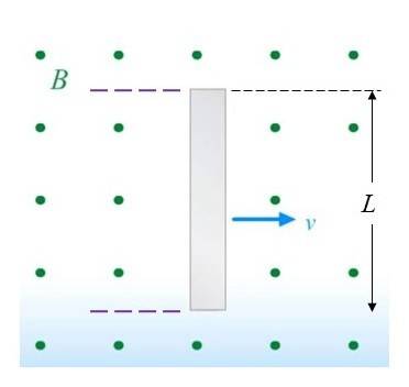

Based on this and the title of your thread, I think there is a more fundamental issue with your understanding of magnetic induction. So let's start with a simpler case.
Can you understand how there can be an induced potential difference (emf) between the two ends of the conducting bar that is moving in the uniform magnetic field, as shown in the figure below? This is a direct application of the Lorentz force law, and also Faraday's law.

It is utmost important to understand that at presence of a time-varying magnetic field there is no potential for the electric field. According to Faraday's Law of induction, which is one of the Maxwell equations, a time varying magnetic field implies an "electric vortex" (in SI units):
$$\vec{\nabla} \times \vec{E}=-\partial_t \vec{B}.$$
The EMF is NOT a voltage, i.e., no potential difference!
It's a very good idea to think about the problem posed in #8. You can solve it in several ways. To use the Lorentz force law is the most physical and simple one in this case. The use of Faraday's law in integral form is a bit subtle, because you need consider the integration over a time-changing surface and its boundary. See the following very nice derivation in Wikipedia:
https://en.wikipedia.org/wiki/Faraday_paradox#Faraday's_law_compared_to_the_Maxwell–Faraday_equation
You'll see that both ways lead to the same result.

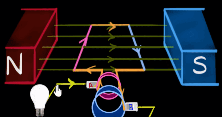

Hi Thanks for the response. There is one more question that comes in my mind. Can you please help in this regard ?
In the below figure they mentioned there are two ways the force exerted, one is from north and and one from south pole. Does electron experience a push or pull from the magnetic field as the pink and blue arrow represents and if yes they are in the same direction (As per flow of electrons) so what is the potential on the end at the north pole of the magnet. Is it the same as the one on the south side but in opposite direction. Let's suppose at point B it is 10V. What is the potnetial at point A, is it -10 V or 0).
