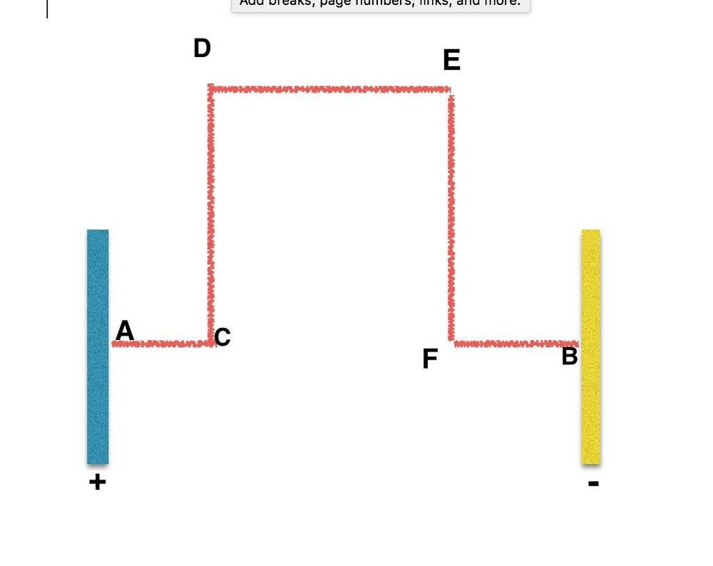

So, my question is how electric field is caused and distributed inside the wire such that electrons flow all the way from negative terminal to the positive terminal. See this diagram:
Blue plate is positively charged and yellow plate is negatively charged, therefore we have straight field lines (ignoring the boundary lines) going from positive plate to the negative plate. All the red segments are conducting wires.
I agree that field lines will push the electrons from C to A and similarly from B to F, but how free electrons of our conducting wire will move from F to E to D and to C. Because for a part of the segment CD and FE the electric field is perpendicular to the movable path of electrons, and for the other part there is no field. Segment ED lies completely out of the field. So, electrons will move all the way through the circuit? Who will push them?
I hope I made myself clear. Please do give your valuable explanation and knowledge.
If the electrons were pushed from B to F but not from F to E then electrons would pile up at F.
What happens due to electrostatic repulsion when electrons pile up at F?
Likes etotheipi and vanhees71

Mutual repulsion. But they cannot go back to B, so only way left for them is to go up to E.
That mutual repulsion amounts to an electrical field. The equilibrium condition will be with a non-zero field everywhere that is just right to sustain the same current flow through every section of the wire.

When a wire is put in place, the E field within the wire follows the wire, whatever E was before the wire was put in place. E=\rho J. E causes j, but j can only flow along the wire, so E must also be along the wire.

This is the problem when you try to discuss Electric circuits in terms of Fields. If ACDEFB is a wire of uniform resistance then why would those field lines be "straight"? The shape of the field will not be straightforward. For uniform resistance wire, there will be field lines following the path of the wire but it will be different elsewhere.
That's the good thing about using Potential Energy unless you really really need to discuss fields.
Likes hutchphd
Another way of saying what everyone else said:
Your assumption that the e-field is uniform and directed from one plate to the other is incorrect once the conductor is introduced. The presence of the wire will cause the field to be distorted, dramatically so in or near the wire.
