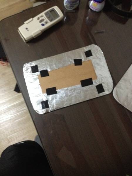

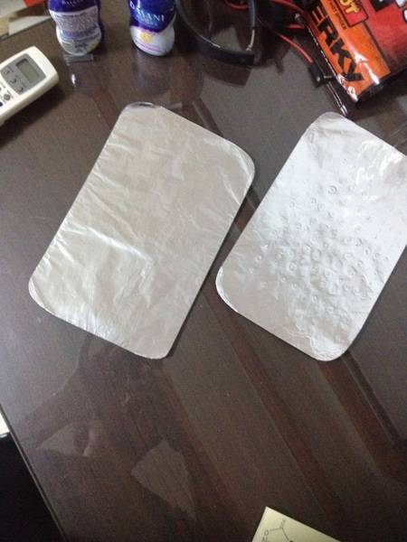

I made two conductive plates out of aluminum foil wrapped around cardboard pieces
i don't have a micrometer with me to measure to the thickness of my paper, so i just googled the average thickness of paper; also just googled the relative permittivity of paper..$$C=\epsilon_r \frac{A}{d}$$
$$\epsilon_r= 3.85$$
$$A=0.21m x 0.146m$$
$$d=0.103mm=0.000103m$$
$$C=3.85\frac{(0.21)(0.146)}{0.000103}=1146.029F$$
what the heck?...
i must've messed up somewhere! because...
(4nF)
The yellow post-it pad and the cup was just to press the plates closer.
1.) what's with the ridiculously high value i got for the capacitance?
2.) what's with the ridiculous discrepancy?unrelated Q: when posting 2000x2000 images, is there a way to just resize it here??
Congratulations on your experimental flair. εr is dimensionless and always occurs in conjunction with εo. You are missing εo in your formula.
NascentOxygen was quicker than me ;)
the value for Eo ist
[tex]\varepsilon_0 = \frac{1}{\mu_0 c_0^{2}} = 8{,}854\,187\,817\,62\ldots \cdot 10^{-12}~\frac{\mathrm{As}}{\mathrm{Vm}}[/tex]
General remark: F is HUUUUGE.
Things may have changed since I dealt with any electronic parts, but from what I remember mF capacitors were rarely used in electronic devices. Most were from the pF, nF and μF range. Your calculation result - in kF range - is a red flag that something went wrong.
Thanks fellas! i still got something in the 10^ -8 but stilll a lot more to what i was expecting.
so 10-50 nF or so? that sounds about right. You can't confirm the thickness of your paper afterall. Also, try to a apply a more uniform weight rather than some post-its and a cup. Use something like a short book.
10-8 is around 10 nF, you measured 4 nF - that's reasonably close, especially taking into account how far from ideal your capacitor is. Distance is not uniform (which is why MrSparkle suggests more reliable way of keeping the surfaces pressed together) and to some degree unknown. Relative permittivity of paper is variable and humidity dependent. Edge effects will change the result further. 10% here, 10% there and you are off by a factor of two.

Dielectric losses may be confounding your meter. Try replacing the paper with a thin plastic bag.
