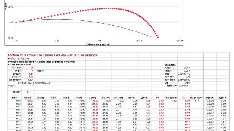

Hi everyone,
Firstly, sorry if this seems a bit rushed, I don’t have much time in between shifts at work. You may have to refer to my links. But if needed, I will add more information later on.
I've been racking my head over this for the last month or so.
I’m kinda doing a private personal project where I need to create a spreadsheet that plots the trajectory of a ball i.e. tennis ball on a graph in the spreadsheet, where the x and y axes of the graph represents the x and y positions of the ball.
The ball needs to be subjected to 3 forces: gravity, air resistance and magnus force (ball spin).
For now, I will assume the spin on the ball will be constant during it’s entire flight path and I’m also ignoring what happens when it bounces on the ground.
I’d like to find the acceleration of the ball, then derive velocity from that, then the displacement/position. All values will be shown on the spreadsheet.

You'll want a simpler model then - say: modelling weight W, drag D, and magnus effect M ... drag depends on velocity, and magnus effect depends on spin.
Decide on what models you want for those ... say: if +y is up and motion is restricted to the x-y plane:
##\vec W = -mg\hat\jmath##
##\vec D = -\sigma v \vec v## (quadratic drag)
##\vec M = k\vec S\times\vec v## ... this give a lift force perpendicular to velocity ##\vec v## and spin ##\vec S##.
##k## and ##\sigma## are the strength of the effect, which you include empirically or just tweek until it feels right.
Commonly ##k = \frac{1}{2}\rho C_D A##... but then ##C_D##, the coefficient of drag, becomes the empirical parameter.
After that there is just the initial condition ... the velocity and position at time = 0 - and ##\sum \vec F = m \vec a##.
Which you want to work as a difference equation for the computer simulation.

So first of all, yes, +Y is up and motion is restricted to the XY plane. X+ is right and so on etc.
Pretty much everything is solved and completed and in plain sight in the first article "42. Ball trajectories".
I can input the initial angle, initial speed, ball mass, etc and get drag and magnus forces... but how do you determine how much displacement or velocity change when a certain x amount of drag or magnus force is applied on the ball?
Since F = ma ∴ a = ##\frac {F}{m}## right?
Then I think my friend said to get velocity from acceleration, you need to integrate... which for me is my roadblock. I can maybe do basic year 10 integrals with some revision, but integrals of gravity+drag+magnus all combined is just way beyond me at the moment.
Ultimately, I just need vx, vy and then the corresponding displacement x, y equations (with reference to time) that I can input into my spreadsheet.
The equations will be something like this:
vx(n) = blah.blah.v(n-1).t - this.that.v(n-1) cos θ...
Attached is what my spreadsheet looks like so far.
I got it off the web somewhere, but the original only took into account gravity and drag, no magnus force.
This is pretty easy since the equations are just the basic physics formulas you see in textbooks i.e. v = at, s = v + at2, etc.
But as soon as I tried to add magnus force to it, it becomes insane and I can no longer keep up with the math.
In the second article I linked (Mangesrai), there was a few equations on page 50. I tried to input the monstrous equation 6.12 and the result was the dotted curve as seen in my spreadsheet. However, adjusting the spin parameters on the spreadsheet essentially does nothing.
In the article it references tait variables of k1 and k2... I just don't get what this is talking about. Also, this only yields the displacement and not velocity at time t.

... OK so you already have a way to find the forces ... force is a vector though, so you need magnitude and direction for this to work.
So let's say ##\vec W## = weight (this is the force of gravity on an object), ##\vec D##=drag, and ##\vec M##=magnus
... that is correct if F is the total force vector and a is the acceleration vector.
Properly, for your case: ##\vec W + \vec D + \vec M = m\vec a##
In my prev notation, I was using i,j,k to indicate unit (magnitude 1) vectors pointing along +x,+y, and +z respectively. The "^" on top indicates a unit vector, where an arrow or boldface indicates a regular vector. If you don't know about vectors and vector components, you should stop here and revise: you cannot proceed without that knowledge.
You only need things in the form of a difference equation ... so if T is a small time interval you can use the kinematic (suvat) equations.
You may just want to try modelling basic ballistic motion to start with, to get used to the methods.
If you decide on a small time interval T, and look at times ##t=0,T, 2T,3T,\cdots ,nT, \cdots , NT## so we have N+1 points of time, which you put in cells in your spreadsheet, Then you can get the next velocity from the previous one by doing ##v_{n+1} = v_n + a_n T##
Here ##v_{n}## is shorthand for ##v(t_n)## and ##t_n = nT: n=0,1,2,3,\cdots, N## you follow?
For this to work, you need to know ##v_0## ... the initial velocity.
This is all magnitudes, so you have to do this for x and y components.
After that ##x_{n+1} = x_n + v_{xn} T##
This process is a form of numerical integration.

Yep, this is what I ended up doing. I used your simplified WDM method and it seems to work well. I calculated the forces, one for x components, one for y components... added them up, divided the whole thing by m, then used the suvat equations as you mentioned to get ##\vec v## and ##\vec s##. Everything is plotted on a graph showing the trajectory of the ball.
Everything seems to work well. . I may post of the spreadsheet later.
I did had slight difficulty finding good k and σ values, but got there eventually through trial and error as you mentioned.
Ideally would've like to use the formulas and values that have been worked out by other people, so that the simulation is as real world as possible. But my attempts were futile and kept coming up with unusual results.
My main concern is the accuracy. If time interval ##T## is relatively large, the results get a bit inaccurate. If I decrease ##T##, then it becomes more accurate at the expense of computational power. My project does require the least amount of CPU usage as possible... but it should suffice for now.

RLst said:
What I'm doing though is splitting up the forces into x and y components for each force with sin and cos, and solving each component of the force vector separately.
You'll have found that the x and y components depend on each other when air resistance is not neglected.
There will be people around interested in it.
I don't use spreadsheets for simulation since GNU-Octave is free. Matlab and Mathematica get used a lot too.
... calculations by other people will be assuming things specific to their models - to be accurate to life you should measure them. You have access to a tennis ball.
It is common to do initial models in a script language like Matlab, just to get the maths right - then do high detail maths using a programming language like C++. There are also a lot of tricks for reducing the computation power needed. Even with all those it is not uncommon to run a program overnight to get a few minutes simulation.
Can I ask how you would go about doing it? Would your method do away with the inaccuracies of large T time intervals?
Whole University papers are taught on the subject.
I'd try to use matrix methods... I'd normally work through the error due to finite time-steps by getting a bigger computer xD but there are tricks like having a variable time-step: shorter for times of high curvature.
What is the density of the ball in this case, and why would I need it? I have the initial velocity + angle of the ball. There is no bounce or rebound to take into effect (yet).
If you were to calculate the drag from the drag equation, like you said you wanted, then you'd need the density of the ball because it is in the drag equation.
But it looks like you've done well with what you know now.
