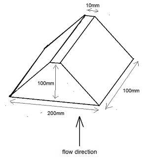

Hey!
I need to calculate the flow pressure drop inside a two dimensional diffuser (please see image below).
The average flow velocity at the inlet is 0.095 m/s.
The fluid is air at a temperature T=373K .
I can't find any close model at any fluid dynamics handbook.
Does anyone know how can I calculate this?
I will highly appreciate any kind of help!
Thanks!
The schematic is not very helpful, at least for me. Can you make a new, more clear one?

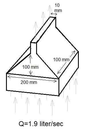

I hope this is clearer:
Much more clear now. You have the Mass flow at the inlet which should be equal to the mass flow at the outlet.
Q(in) = Q (out). From this you can compute the outflow velocity (and you already have the inflow velocity).
Then, provided the flow is incompressible, you have Bernulli's equation to calculate the pressure drop...
