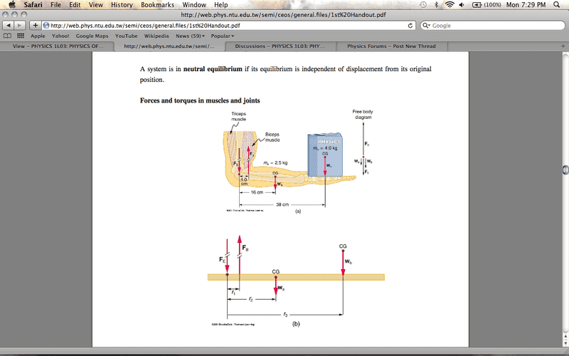

How can I calculate the force needed to hold a book on a forearm?
  • Thread starter rice1am
In summary, the conversation discusses how to calculate the force required to hold a forearm and book using torque equations. The person asking the question initially assumes that the torque of the book is equal to the torque of the forearm, but is informed that this is incorrect. The solution involves setting an origin at variable positions and analyzing 3 torques, 2 of which are known. It is also important to consider the convention of positive and negative torque in calculations.
rice1am
Figure shows a forearm holding a book.
a.) Calculate the force the biceps muscle must exerts to hold the forearm and the book.
**all answers should be in three sigdigs.
[tex]\tau[/tex] = Frsin[tex]\theta[/tex]
F=ma
Well, I assumed that the torque of the book = the torque of the forearm; so, I just assumed that the F of the book = F of the forearm.
But I know that's completely wrong, and the answer has been provided by my prof, but she did not provide an explanation as to how she got that.
Please if anyone can answer my question! I have an exam on Wednesday and physics was never my best subject :| Thanks!
**Image of the problem is provided**
Hi.
What you want to do is set the origin at variable positions.
For a system to be in equilibrium you need the sum of torques to be zero.
If you set an origin centered at the line of action, you will effectively eliminate any torque the force produces.
That leaves you with 3 torques to analyze, 2 of which are known.
It is important to note the convention of positive and negative torque in your calculations too.
