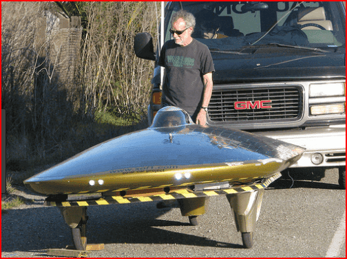

@Xander -- have you read through pages like this?
https://www.xof1.com/specifications.php

Yeah, but that's also 5m long and 1.8m wide, and clearly designed for aerodynamics and low rolling resistance. 900 watts is still only around 1 horsepower, which is really not very much for a human-carrying vehicle. The acceleration will be sedate at best.

Agreed, I mostly just wanted to get the OP thinking along the lines of what his kart specifications are, so he can get closer to calculating the details like power, gearing, aero, etc. :smile:

Unless solar panels have improved much from the vehicles like the one linked to above:
the top speed will fairly low unless the design mimics that vehicle. 900 watts is about 1.2 hp, and that is a fairly large solar panel on that vehicle. I'm also wondering what the limits are in terms of cross winds before it becomes dangerous for that vehicle.
