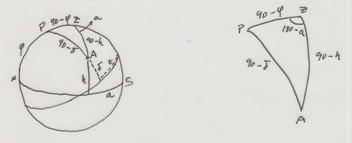

The fastest way of making that coordinate conversion is to use a web page or a formula. But it's more instructive (and transparent) if you make a sketch of the celestial sphere, such as this one I'm supplying. You still need formulas, but you know what you're doing with them...
The latitude of the place from where you have made the observation is phi (the altitude of the pole). And h is the altitude of the star that you have measured. The angle comprised by the two sides is 180º-a, where a is the azimuth of the star, measured from the south (ZS is the meridian of the place).
At the right side, I've isolated the relevant spherical triangle. You need to find a formula, in the internet or elsewhere, in order to find the side 90º-delta (delta is the declination to be found) for the spherical triangle with two known sides, 90º-h and 90º-phi, and the angle comprised, 180º-a.
Thus, you get the declination delta. Now, you need the right ascension: RA = sidereal time - hour angle. As the three side are now known, you can use another formula to find the angle APZ, comprised between 90º-phi and 90º-delta. Its value is the same as that of side t, the hour angle...
