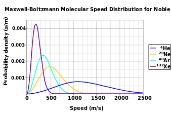

It gives the following output:
But, according to this link, the graph should look like the following:
I didn't go through the code/algorithm in detail, but this line would seem to be the reason that the program cuts off there, no? Where did the number come from? Did you expect the distribution to be done by then? Also, are you wanting to plot all 4 distributions from the graph you posted? Sorry if it's obvious, but I didn't really go through your code and assumptions in much detail yet.
int binsCount = 51;
