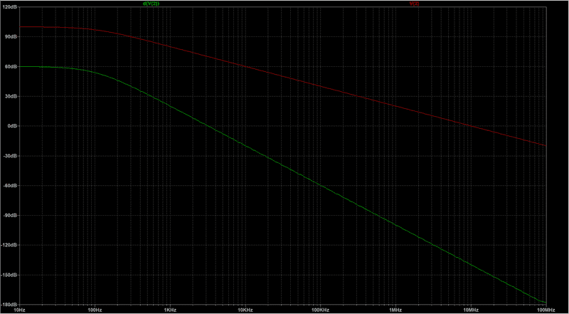

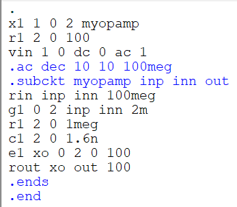

I use this netlist and simulation result came out as shown. I need to find the dc gain here and circuit diagram, but I'm not sure how. I would be very grateful if you could give me the answer.

I'm sorry, but I don't have data on the schematic. Because of the professor's instructions, I only have the netlist, and I have to run the simulation through it and find out the results. The result of the ac simulation is like the picture, and I don't know how to find the dc gain here.

OK, but I suspect your professor is an idiot, schematics are how we communicate in electronics, JMHO. For a simple circuit like this we can usually read the DC gain as the ratio of some resistors, without any simulation.
Anyway, you can approximate DC as ##f \rightarrow 0##. So, if you graph the AC response and you get the same constant gain at the small values of ##f##, then you can usually assume that that is the DC gain. For bonus points you can also check that the phase shift is ##0^o## or ##180^o##, which is what you normally get when the gain isn't changing.

I very much agree that the professor is an idiot. You said that the part that is kept constant becomes the dc gain, and in that graph, 100dB seems to be constant. But 100dB itself can't be gain, so please tell me what additional steps should be performed through ltspice to get dc gain. I've looked it up on Google before, but I've given up on it because it's so vast and has so many irrelevant answers.

100 dB can be the voltage gain. The input is AC 1 volt.
Convert 100 dB to a voltage ratio or;
Select the left axis of plot, manual change from dB log to linear, then read off the DC gain = your answer.

Maybe not. I think the schematic is not given in the hope that the student will create a schematic by learning to decypher the spice source code using the help files. It is worth the exercise.
