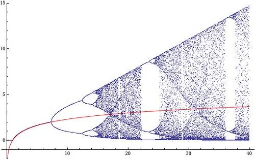

Then you get the standard story of period doubling -> chaos -> period 3 -> doubling -> chaos -> etc...
You can generate a nice picture in Mathematica using something like
Code:
f=Compile[{{n,_Integer},{x0,_Real},{r,_Real}},Union[NestList[r # Exp[-#]&,x0,n][[-10;;-1]]]];
Show[{
  ListPlot[Flatten[Table[Thread[{r,f[1000,.01,r]}],{r,0,40,.01}],1],PlotStyle->PointSize[Tiny]],
  Plot[Log[r],{r,0,40},PlotStyle->Red]}]

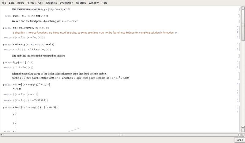

I think you need to really think about what you want Mathematica to do for you.
For finding the stability indices, you probably want to stay symbolic the whole time.
I've attached a notebook that should do everything you want. Here's a screen shot of it:

Thank you very much!
I am studying it right now.
I used y[x_,r_]:=r x Exp[-x]
but then i did a mistake i think at Solve[y[x, r] == x, x]
But i would have not think the
Solve[(1 - Log[r])^2 == 1, r]
Thanks again!
You were very helpful and understanding.
Hello,
I have only one question for the fixed point x=1-Log[r].
If 1-logr<1 =>-logr<0 => logr>0 => r>1 then the point is stable.
Until here ,ok.
Why you are trying to solve (1-logr)^2=1 ?
(You are trying to find the limit of r value for the equation to be stable,but i can't figure the way)
As for the bifurcation diagram i did it with iterations with "while" and "if" commands and as i can see its the same.

Sorry for asking in this old thread, but my problems are related to this code which I'm trying to learn.
What's the meaning of the [[-10;;-1]] span? I really cannot understand it, and breaking the function in smaller parts doesn't help...
Hi cenit, not a problem.
[[]] is an abreviation for http://reference.wolfram.com/mathematica/ref/Part.html" , and as explained in the documentation, negative integers reference a position from the end.
Assume you have a list called L. Then
L[[1]] gives the first element.
L[[1;;5]] gives the first 5 elements.
L[[1;;7;;2]] gives the elements 1,3,5,7.
L[[-1]] gives the last element
L[[-10,-1]] gives the last 10 elements.
I did this in the definition of the function f, this since we need the recursion to stabilize onto the attractive solutions - thus we keep the last 10 points and throw away the "junk" that came before. There are probably more smart and more efficient ways to do this, but for a quick forums solution, it was enough.
