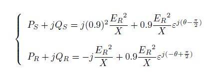

Hi,
how do I find the center and radius from these equations? The 2 equations represent 2 different circles, by the way.

I forgot to mention that P+Q is a complex number in the form Z= X+iY because P is the real power while Q is the reactive power.
I will work the 1st equation. I will eliminate subscripts to make the notation simpler and also let \(\alpha = \theta - \frac{\pi}{2} \) and \(K = \frac{E^2}{X}\)
So the 1st equation becomes:
\(P + Q = K(\,(0.9)^2j + 0.9e^{j\alpha}\,)\)
we know that \(e^{j\alpha} = \cos(\alpha) + j \sin(\alpha)\)
so the 1st equation becomes:
\(P + Q = K[\,(0.9)^2j + 0.9(\,\cos(\alpha) + j \sin(\alpha)\,)]\)
or
\(P + Q = 0.9K(\,\cos(\alpha) + j \sin(\alpha)\,) + (0.9)^2Kj \)
so \(P + Q\) as a function of \(\alpha\) is a circle of radius \(0.9K\) and center (\(0.9)^2Kj \)
