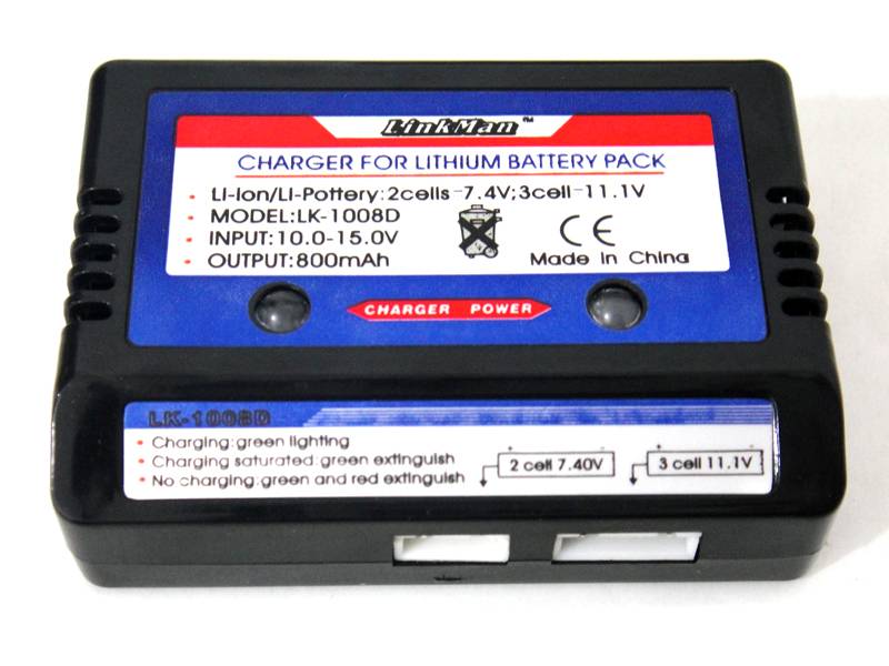

This is my charger:
It reads:
Output = 800mA
Does it mean that it draws 800mA from my power source?
No. It draws as much as it needs. Note it requires at least 10 V on the input side, not 5 V that you have in your powerbank.

karabiner98k said:
This is my charger:
View attachment 221538It reads:
Output = 800mA
Either that's a typo/bad English confusing ma for mah or it's just what type of battery it is designed for and has no relation to actual output amperage.
There is a decent chance the USB+ converter won't even run it, but even if it does it will take a long time to charge(at least an hour)...
Yes, that's a typo or bad English! Chinese!
It means Output Charging Current = 800mA (0.8A)

karabiner98k said:
This is my charger:
Output = 800mA
No it means it delivers 800mA (0.8A) to the cells being charged.

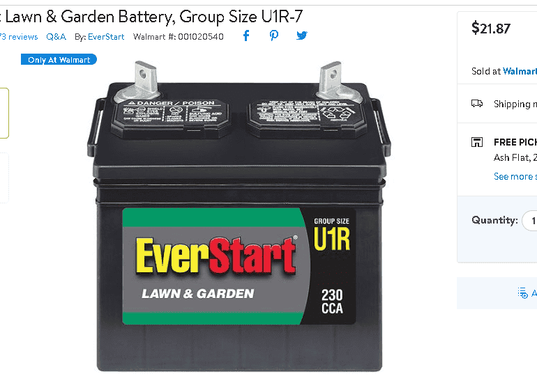

sophiecentaur said:
12V batteries are available in all sorts of capacities.
They are certainly much more expensive. Could you please show me the picture of one of them?
The original factory charger charges my battery in 1 hour 15 mins (wall socket adapter), so I have no problem if charging the battery with the converter takes an hour or so.
1 hour delay between flights is good for the helicopter too because the motors have time to cool down.
Look on eBay for lead acid battery and you will find many 12V examples. I saw a Yusa 12V 7Ah at £14.69. Search yourself and find what's available in your area. A charger (motorcycle application) can be obtained for about the same cost. Buy some thicker wires than you initially think you need and you are in business.
If I were out in the field, I would find waiting one whole hour for my next flight could be a real pain in the butt at times. The problem is that the 'USB' power source is not really 'Universal' as its name suggests. There's often a mismatch between the requirements and the capabilities although, give them credit, they do allow many peripherals to work seamlessly. But a model helicopter is in no way a Computer Peripheral and something has to suffer if it's treated as one.
I do sympathise if you are finding this all more expensive than you planned. Your solution to this may well be a bit of cheap DIY but you run the risk of needing to do it all 'properly' later on and finding you need to spend even more money. What if you decide to get a bigger and better aircraft, for instance. In that case your present marginal solution could be inadequate,
