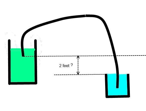

I have been trying to control the water level in a water hole that I have using a siphon system. I have a 1.5 inch hose that is submersed in the upper water hole and the hose travels slightly up hill for a 100 feet then goes slightly down hill for the other 100 feet into a large barrel of water which just overflows during the siphon process. The water level of the top of the barrel is the level I want to achieve in the upper water hole. Everything works very well for about 6-7 hours of siphon but eventually small amounts of air bubbles build up into large air pockets and siphon is eventually lost. I can't really change where the hose is. How can I release this eventual build up of air automatically without losing the siphon. Is there some kind of valve? Or some trick that can be used to stop the build up of air from traveling down the hose? I have been reading that there are various reasons why the gas build up is happening. I can't really change that but I am hoping of a way to dispose of the gas? Any help would be greatly appreciated. Thanks

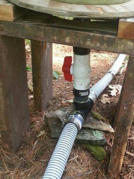

we have decided to install a small battery operated vacuum pump that only turns on when a certain amount of gas is gathered at the top of the siphon. Will let you know how it works

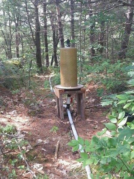

So I am still fighting with gasses collecting in this siphon system. We added a container at the highest point of the siphon system with a shut off valve. The container was filled with water. Our idea was to for the container to catch all the gases and replacing the water in the container with the gas. The shutoff valve would allow us to remove the container to remove gas and refill with water. If this would have worked we would have used a larger container so that it wouldn't have to be refilled as often.
We primed the siphon and once it was working we opened the valve. To our surprise the water was sucked out of the container so fast that it flattened the container. Fail! Our thought now is to get a container that won't collapse. Any other suggestions? Is there some kind of auto air bleeder or degassing valve that would work in a siphon system? It certainly would make this a lot more simple to achieve. We can get the siphon to work for a few hours and then the gasses build up enough that it losses the siphon. Getting rid of these gassed is proving to be a lot more difficult that I had thought.
You will need a transparent vertical canister between two ball valves, all mounted on a T connector at the highest point on the siphon tube.
Repeat the following cycle whenever you need to remove low pressure gas from the top of the syphon tube.
A bleeder valve won't work because as you found, the system is negatively pressurized at the top. You need a rigid container, capable of handling a pretty healthy vacuum without collapsing. Your (Baluncore's) solution was a good one, you just need a stronger container.
Baluncore's suggestion to use a bundle of small tubes, is very clever indeed. It would make a fun project for students to find out how small the tubes have to be.
this is what we tried so far. Seems to work so we need to get a larger canister now. I would like to try a collection of smaller tubes though. I just have so much money invested in this right now.

grizzster said:
The top of the barrel is about two feet lower than the intake hose. If the water in the ditch drops two feet the water level in the ditch and the lower barrel will be at the same level and siphon should stop. If water then increases in the ditch the siphon should just keep going since both ends of the hose is still submerged.
So it appears there is almost no head to overcome resistance to flow through the siphon pipe.
That's not right. The syphon will keep going until the water level drops below the height of the intake hose and then air will enter the intake.

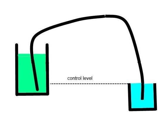

Is this actually what you have?
The syphon should run until the level in the ditch on the left falls to the control level (top of barrel on right).
