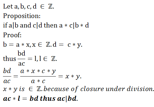

Is this proof even correct?! It places assumption on a and c NOT BEING ZERO.
Thanks in advance. I am new to proofs.

mfb said:If a|b, can a be zero?
If c|d, can c be zero?
If not, that case is not relevant for the proposition.
No number can be divided by zero. Zero doesn't belong to multiplicative groups by definition of the group properties and zero as the additive neutral element.Bipolar Demon said:No, I think. No real number can be divided by zero
Mark44 said:The order of your proof needs work. You say
"Thus ##\frac{bd}{ac} = l, l \in \mathbb{Z}##"
Then you talk some more about ##\frac{bd}{ac}##, which should come before saying, "Thus..."
Here's what I think is a more direct proof:
a | b and c | dWhen we say that a number a divides another b, both numbers are assumed to be integers, and a is assumed to be nonzero.
Then b = ka and d = mc, for integers k and m.
So bd = kmac
Hence ac | bd.
