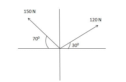

How can I know which law of force should be use to calculate magnitude and direction for any diagram?
Triangle law of forces
243841
for this diagram, I want to use Triangle law of forces, but I am not sure about final answer.
So how can I know which law of force should be use to calculate magnitude and direction for any diagram?
What are you trying to calculate? If you want to sum those forces, there are several ways to do so. Realize that you can move the force vectors around so that they can be added as a triangle.
I want to calculate magnitude and direction.
Of the sum, I presume. Try moving the 150 force so its tail hits the tip of the other vector. You can translate vectors as long as you don't change their directions.

I presume that by "triangular law of force" you mean the "head to tail" method of vector addition? That way they form a triangle, which you can then use to find the resultant.

Not sure what the "parallelogram law" is, but you can use ANY method to add the two vectors.

Nothing wrong with that. (To me, those are sort of the same thing: Graphical methods of adding vectors.)
The real trick is to move the vectors so that they are head to tail.

You can always use the parallelogram law, but it's a geometric proceeding so you will need a ruler to measure the final result and you will have errors. Triangular law of force, if I understand what you mean (please explain what do you understand by this) can be used also to get the correct values with mathematical operations.
Gaussian97 said:
I think that "triangular law of force" means the cosine rule.
Yep. And I'd use that rule even for the parallelogram method (there's a triangle in there) so you can get an exact answer.
(In reality, I wouldn't waste time with either: I'd just add components.)
