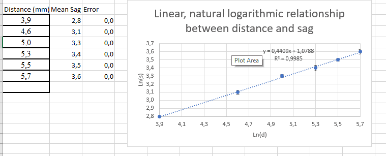

My "linear" graph looks like this:
With the graph, ln(u) is my y-intercept and t is my gradient to complete the equation in my hypothesis.

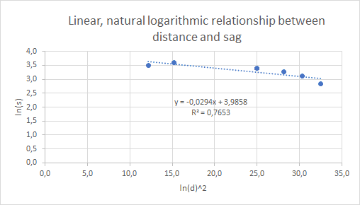

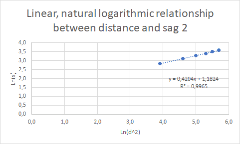

Now onto what we discussed: From what I understood, I plotted two graphs:
ln(d)^2 and ln(d^2). However, they both looked almost the same as my original graph:
What doing wrong?Deleted reply:
Thanks a lot for the response, this is my first time really working with graphs.
I got this line which looks better:
However, when I plug it into my equation:
ln(s) = tln(d) + ln(u)
ln(u) = 1,0788 (y-intercept)
t=0,4409
ln(s) = 0,4409 ln(d) + 1,0788
s = udt
u = e^1,0788= 2.9411
s = 2.9411d^0,4409I try and insert a distance i.e. 50mm: s = 2.9411*50^0,4409
I get an answer of s = ~16.5mm, which is completely off my measured 34.9mm.
Could you provide some insight on what's happening here?

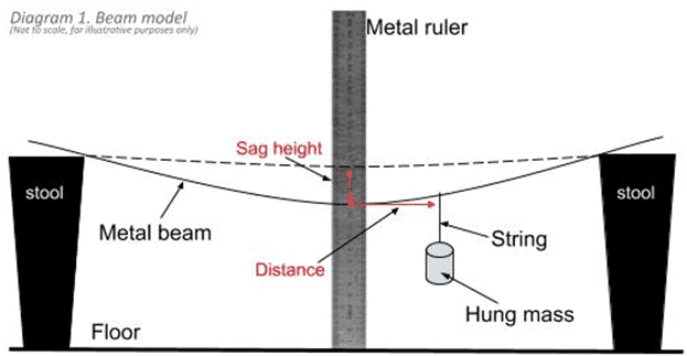

How are you defining sag? According to your original equation sag=0 at d=0. Not sure what you are doing here, so please elucidate.
utp9 said:
s=ud^t
That is my equation for sag. My power of t didn't transfer over from word, sorry.
For my investigation sag is the amount of vertical depression the beam endures when applying a mass at different points from the midpoint of the beam. Distances of: 0.0, 50.0 100.0, 150.0, 200.0, 250.0, and 300.0 (mm)
Do you need any more information?
I'm confused as to the geometry. How long is the beam? Is it supported at the ends or cantilevered? Your data looks good but not for the experiment I have in my head...
The beam is a double overhanging beam of 1000mm with 50mm overhanging each end. So, 900mm between the two pivot points.
My diagram:

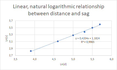

I have spent some time with my problem.
Here is a summary of where I'm currently at.
When reversing my graph's y-axis I can almost get an almost perfect line. This line gives me the correct slope and intercept, if I insert the distance in reverse.
i.e. if I insert 50mm distance into my equation I will get the result for 300mm, 100m gives 250mm result, etc.
ln(u) = 1,1824 (y-intercept)
t=0,4204
ln(s) = 0,4204*ln(d) + 1,1824
s = udt
u = e^1,18248= 3.2621
s = 2.9411d3.2621
i.e. d = 50mm
2.9411*503.2621 = 16.9mm which corresponds to sag for 300mm
2.9411*2503.2621 = 33.2mm which corresponds to sag for 100mm
Here is said graph:
ln(Distance (mm))ln(Mean Sag (mm))
5,7
3,6​
5,5
3,5​
5,3
3,4​
5,0
3,3​
4,6
3,1​
3,9
2,8​
(In original graph 3,9 was first and 5,7 was last, others were reversed as well
Now, how can I get a correct result?

Thanks for the drawing.
Just looking at your data it is clear that the displacement should be measured relative to the maximum value (35.0mm), so your quadratic hypothesis should use this relative displacement. Your original quadratic supposition should define "s" as relative displacement. As I mentioned previously your original proportionality s∝dt requires d=0 to give s=0 so clearly you need to start there. Otherwise this is hopeless from the start!

When your data is plotted as ##(\ln(s), \ln(d))## can you closely fit a straight line to it or not? From your previous posts, I can't tell. In post #4, is the material after "deleted reply:" supposed to be something you want deleted?
The goal of your graphical analysis is find a transformation of the data that makes a straight line. If the ##(s,d)## data is not consistent with the hypothesis ##s = ud^t## then no sort of transformation of the data will support the hypothesis that ##s = ud^t##. If you find a way of transforming the data that gives a nice straight line, you should change the hypothesis to something that is consistent with that transformation.
As to your previous post, it isn't clear what you are doing. You speak of reversing the Y-axis and you also say "if I reverse the distance", which is something plotted on the x-axis. State the format of the data you are plotting. What does "reversing" mean mathematically? Is the format ##(\ln(s), ln(2m -d))## where ##m## is the midvalue of the distance measurements? Or perhaps it's ##(\ln(s), 2m - \ln(d))## where ##m## is the midvalue of the natural log of distance measurements?
If you aren't plotting ##ln(d)## on the x-axis then change the label for the x-axis to indicate what is being plotted.
Let's suppose that we can fit a straight line to the format ##(\ln(s),ln(2m-d))##.
So we have ##ln(s) = A \ln(2m -d) + B ##. The hypothesis this supports is ## e^{\ln(s)} = e^{A \ln(2m-d) + B}## which is equivalent to ##s = u(2m-d)^t ## where ##u = e^B##, ##m##, and ##t = A## are constants. I don't think this describes what you actually did. It only illustrates the idea that you must change your hypothesis to match whatever was done in transforming the data.
