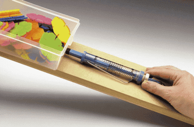

For a personal project I am doing, I want to test a range of forces in the horizontal direction, and see how the device I created reacts at different forces. So for example, if I want to apply 5N specifically to a device, to see how it reacts under that force, how would I go about applying it? Like applying a specific amount of force. Because I can measure displacement, and I can push on my device with my own fingers, but I don't know what amount of force I am pushing with. I want to know specifically the amount of force.
Something like a dynamometer, but instead of knowing the force being applied to the dynamometer, I want to replace the dynamometer with my device. And I know spring force meters can measure a force, but I want to take a measured force and apply it to something.
Put a platform scale between your finger and the device and push.
Connect a pull scale (fish scale) to the far side of your device and pull.

I considered these previously, but I don’t think they’ll work. My device is in a symmetrical (along the y-axis) oval shape, and in typical use, force would be applied to both the long sides (along the x-direction). So I want to apply a force to one end and see how far inwards it will deform (which would also theoretically be happening on the other end since symmetrical...)
So for the latter, I want a push force against the device, so that wouldn’t quite work. For the former, it wouldn’t really reflect the testing conditjons I want, I think. I don’t want to completely smush the device.

How about a Push/Pull meter like this one?

Combination of string pulleys and weights?
Amarah said:
That looks promising! Would a push force gauge be similar? I think that could work.
That *is* a push force gauge... Notice how it is being used to push that box UP the ramp...? :smile:
Use the link to the picture to get to the website. It looks like they sell several different styles of force gauges.
