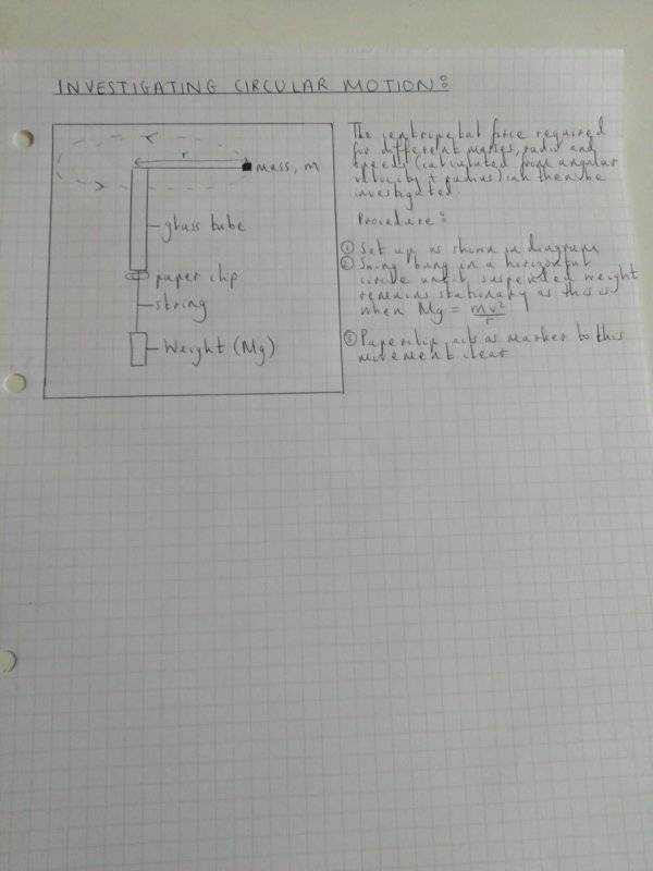

- Homework Statement
- What are the systematic and random errors associated with this experiment? How can I reduce the effects of these? How can I reduce percentage uncertainty?
- Relevant Equations
Random error would be to do with not swinging the bung in a perfect circle so when I try to measure velocity, that would vary. Measurement of radius.
How would I decrease percentage uncertainty?
Use a smaller mass so that I get a larger radius so I can measure a longer length.
