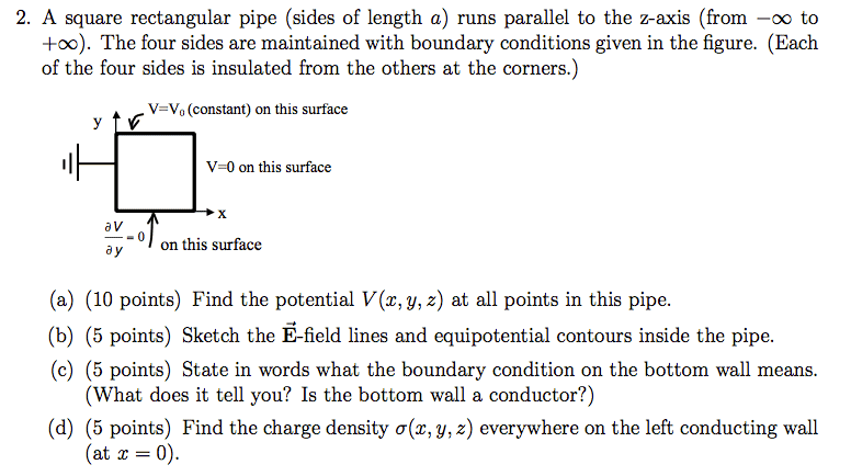

The problem is given in the attached picture, but I already have a solution to part a) which I am confident in (I have checked it carefully, compared to other students and confirmed it with my graduate-TA).
Part b) asks us to plot the equipotentials but I cannot figure out how. I cannot get this infinite series into a form which I can use to plot. I have tried several online calculators, I have tried separating the series into two different series and re-writing it a number of different ways but I cannot get it into a usable form.
V(r,Θ) = Σ (2V0/a)[(1-(-1)^n)/cosh(n*pi)]cosh(n*pi*y/a)sin(n*pi*x/a)
See above. I think I can answer part c) and I have an answer to part d) I just need a form of this solution which can be used to plot equipotentials in the x-y plane.
As near as I can tell, you mean to say that your result is
##V(x,y) = \sum_{n=1}^{\infty} \frac {2V_0 [1-(-1)^n] \cosh(n\pi \frac y a) \sin(n\pi \frac x a)} {a \cosh n\pi}##
I don't see how this could give you ##V = V_0## at ##y = a##. At ##y= a## your solution would look something like
##V(x,a) = \frac {4V_0} a ( \sin(\pi \frac x a)+ \sin(3\pi \frac x a)+ \sin(5 \pi \frac x a) + \dots)##
but what you need is a square wave. You are almost there, but it is not quite right.
Your answer to (a) looks wrong just from looking at the units. Your expression has units of volts/meter, but it should just be volts.
As far as plotting the equipotentials go, you might simply be expected to use software that can do that for you.
Thanks to both of you who replied. You are both correct. There is no 'a' in the denominator, my mistake. I plotted 1000 terms of the (correct) series in Mathematica in order to read off the equipotentials.
The series does converge to a constant at y = a.
