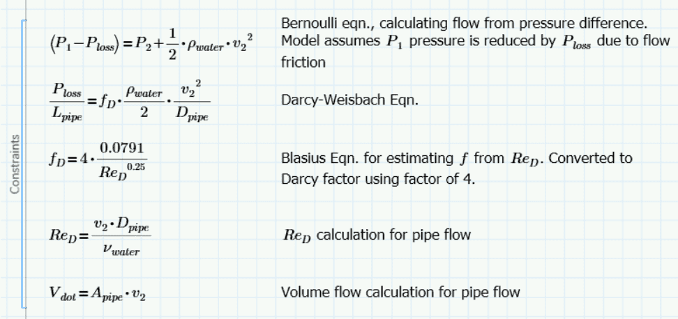

Hello!
I hope you are all doing well! I've been always intrigued by fluid mechanics and decided to try out a quick experiment with my water faucet. After using some equations I found online [1] [2], I plugged a hose to the faucet and let the water run. I filled a 1 quart bowl and recorded the time it took to fill it. Without closing the valve, the experiment was repeated several times.
After comparing the experimental to theoretical results, there was a huuuge discrepancy.
Could you please help me see where the problem is? I feel like this should be a very simple problem...

That's not what static pressure means. The pressure measurement with flow off is both a static pressure and a total pressure measurement since there is no flow. With flow on, those two values are different, and neither of them necessarily equals the pressure you measured with the spigot plugged. The word "static" in this case is used as an adjective for something pertaining to the state of the fluid, not to convey information about whether it is in motion. It is the thermodynamic pressure of the fluid.
I would say you have a lot of pretty huge problems here.
  1. Your volumetric flow rate is 100% not correct, as you are not getting 5144 gallons per minute out of that hose. You are at least 3 orders of magnitude too high there. Your velocity and Reynolds number calculations are therefore way off as well. This is probably due to a unit mismatch, as you give no indication of what values you actually plugged into the Hagen-Poiseuille equation. If your unit system wasn't self-consistent (and it doesn't seem to be if you just used the values you have above that), then your answer will be nonsense.
  2. You are improperly using the Hagen-Poiseuille equation. Hagen-Poiseuille applies strictly to laminar flows, and your flow is likely turbulent.
  3. You are improperly using the Darcy-Weisbach equation. It applies to either laminar or turbulent flows, but for laminar flow reduces identically to the Hagen-Poiseuille equation. You can't use them together like that. The Darcy-Weisbach equation is actually meant as a correction to the Bernoulli equation to account for frictional losses and that is how you use it.
For instance, if you call the outlet of your valve location 1 and the outlet of your system as a whole location 2, then you would set up the following equation:
[tex]\left(\dfrac{p_1}{\rho} + \dfrac{V_1^2}{2} + gz_1\right) = \left(\dfrac{p_2}{\rho} + \dfrac{V_2^2}{2} + gz_2\right) + f\left(\dfrac{L}{D}\right)\dfrac{V_2^2}{2}.[/tex]
Since this is water, you could also relate the two velocities by noting constant volumetric flow rate. You would still need to determine ##Re## and ##f##, which would likely need to be done iteratively.

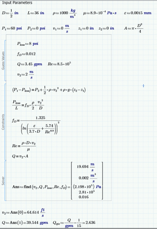

@boneh3ad Thank you very much for your reply! I think I was using the Hagen-Poiseuille equation to confirm that the flow was turbulent, but using the resulting Reynolds number for the Darcy-Weisbach is not correct, you are right. Also there should be no unit errors since the software I'm using takes care of them. Then, I noticed that if I put my pressure gauge after the valve and let the water flow through the entire hose, it reads a pressure between 0-1-psi, so I would guess that this is the dynamic pressure (P_dyn), and that the pressure I measured with the spigot plot (p_total) minus p_dyn = static pressure? Interestingly, for any numbers between this range, the equations I used actually do a better job approximating the experimental values.
So is there any way I could theoretically calculate the dynamic pressure from a total pressure known (from a pressure vessel or tap)?

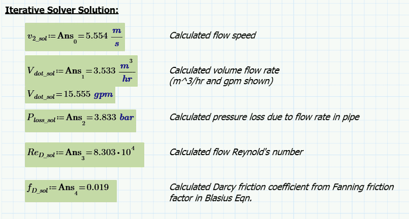

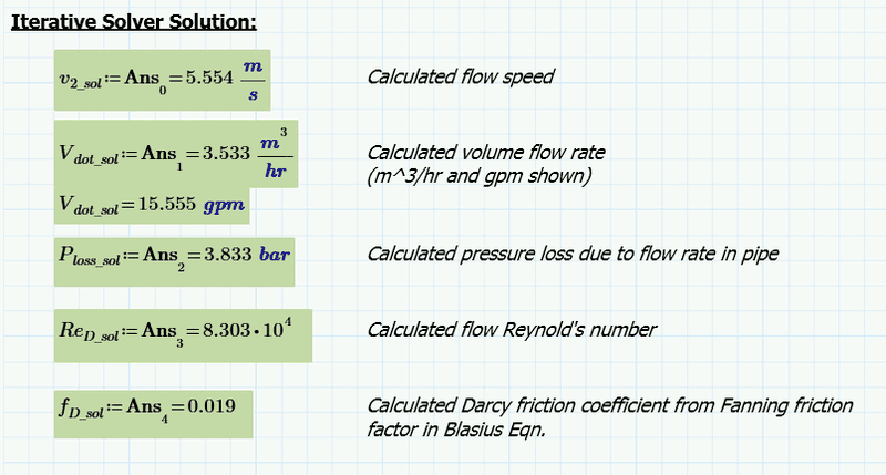

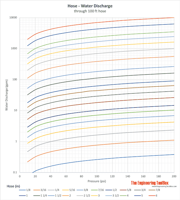

Mech_Engineer said:

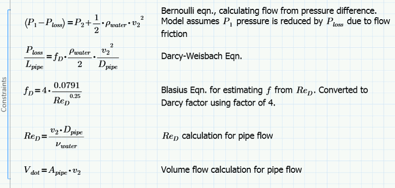

Great catch, I got sloppy with my friction factors and wasn't distinguishing between Fanning and Darcy.
Here's the updated equation set:

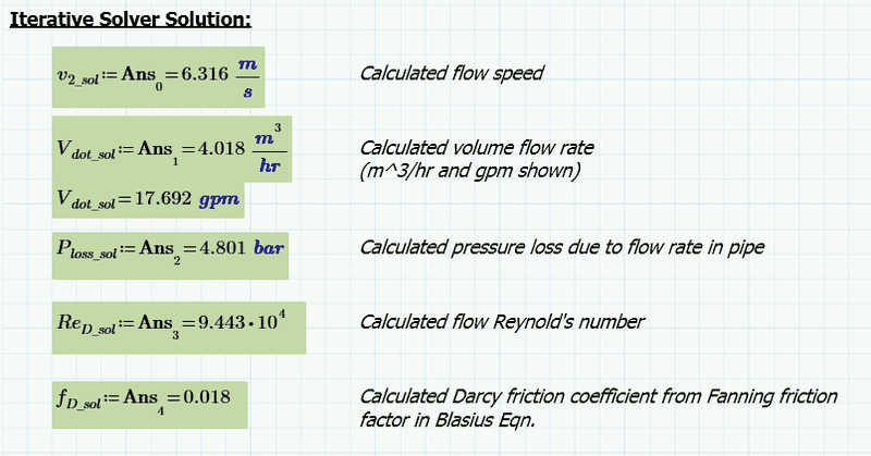

And the results:
Looks like this is about as accurate a calculation as I can provide given the parameters known? Thanks @Chestermiller and @JBA , I learned a good deal in this thread!

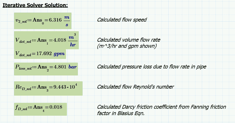

Mech_Engineer said:
I thought of one more possible error- the water main's pressure will probably be specified at gauge pressure, meaning the discharge pressure P2 would be zero, not 1 atm (gauge pressure of zero).
That increases the flow a bit, see here:

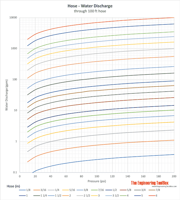

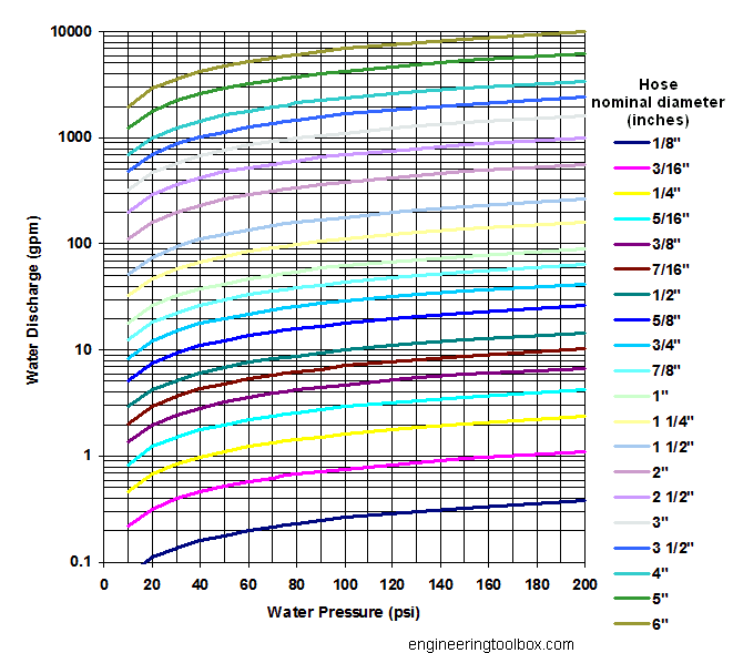

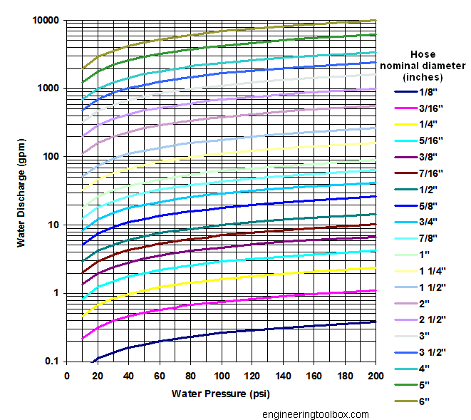

I also tried a quick check by comparing calculated flow rates against a hose discharge chart here: http://www.engineeringtoolbox.com/water-discharge-hose-d_1524.html. The flow rates calculated by my sheet appear to be right in-line with the values from this chart.
Calculated values from my sheet (100 ft length for all):
  • 1/8" hose, 100 psi: 0.25 gpm
  • 1/2" hose, 40 psi: 6.38 gpm
  • 1/2" hose, 100 psi: 10.75 gpm
  • 3/4" hose, 40 psi: 19.02 gpm
  • 3/4" hose, 100 psi: 32.03 gpm
  • 6" hose, 10psi: 1965 gpm
  • 6" hose, 60 psi: 5202 gpm
Compare to chart from EngineeringToolBox.com:

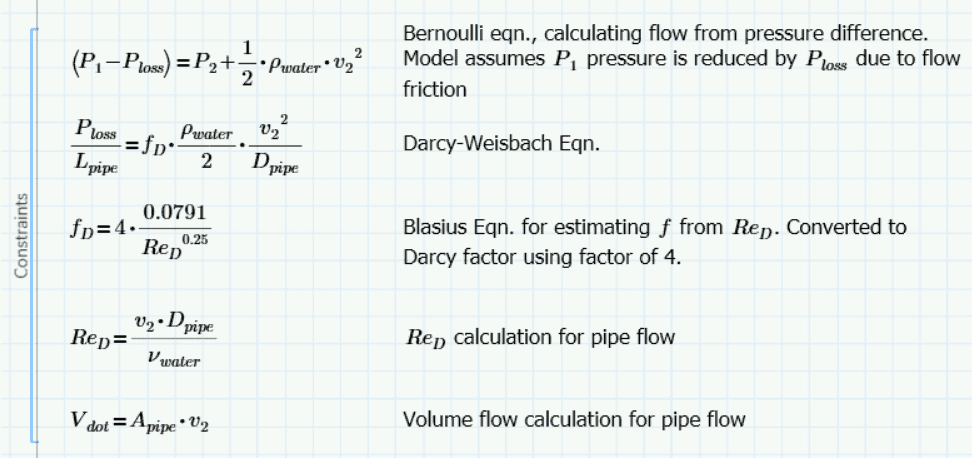

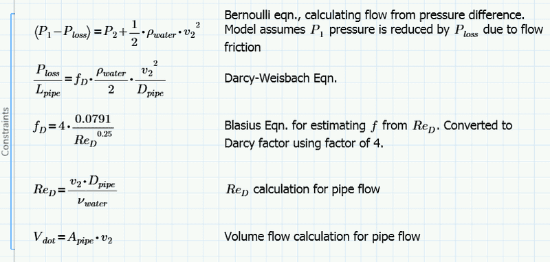

Mech_Engineer said:
For reference, the equation set used in that MathCAD sheet looks like this:
I used a numeric solver and some trial and error to get it working, but in the end the calculations looked to match very closely to the estimates on Engineering Toolbox's site: https://www.engineeringtoolbox.com/water-discharge-hose-d_1524.html
@Mech_Engineer Thank you very much! I tried using the same equations you used in mathcad but I'm sill getting a similar result which is off by a factor of 10 :/
The equation set I have gets the same answer you get within 10%. I'm guessing the other aspects of your experimental setup (valve flow rate, tank pressure, etc.) are having an effect on the result. The calculations I was doing were for a 100 ft hose, where the length of the hose dominated the flow characteristics.
