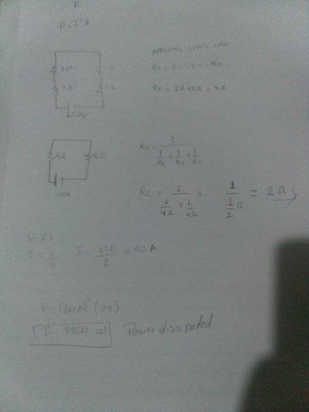

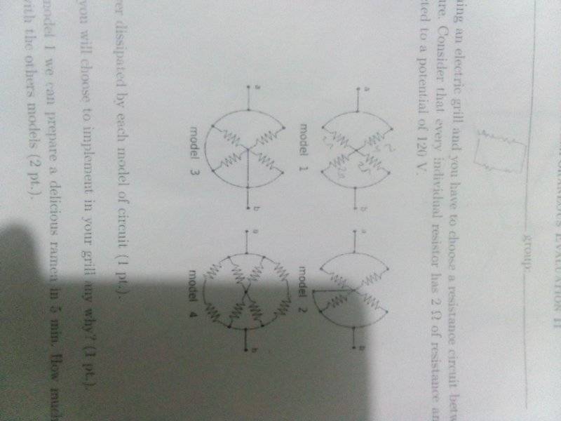

Hi have this problem but I don't know how to represent, however I've tried.
The problem says: You are designing an electric grill and you have to choose a resistance circuit between the circuits shown the figure. Consider that every individual resistor has 2 Ohms of resistance and the terminals a-b are connected to a potential of 120V.
And then:1) Find the power dissipated by each model of circuit.
2) If using the model 1 we can prepare a delicious ramen in 5 min. How much time it takes to prepare with the other models.

It's the second photo
What I want to know is how the othee models are represented on a electric diagram and know if it's correct my first attemp with the model 1

Then, what I've done is placed the resitances in such way they are like in the diagram I did and the equivalent resistance is 2 Ohms.
Then I applyed the formula of power in order to find the first statement.
Like this: Re= 1/1/4 + 1/ which is equal to 2 ohms.
Now I put it on the formula:
P= 60^2Ampers * (2 ohms) then i got 7200 whatts.
Is this correct?. Am using well the formulas?
And finally Is the diagram i did ok?

I forgot to say the Voltage is equal to 120 so, by applying the formula I= V/R it's 60 Ampers
GaussianSurface said:
1/1/4 + 1/
I have no idea what that means, but 2 Ohms and 7200 Watts are correct.
As I wrote, the diagram is too faint for me.

Im sorry it was 1/4 I'm typing from my cellphone and I have some mistakes so now that I'm going I am good way, how can I find the power of the next models that are in the figure? they've got another nodes and so... Please help me
Im sorry it was 1/4
Then how did you get 2 Ohms?
For model 2, can you find two points connected by two paths each with a known resistance?

By applying the formula of equivalent resistance.
And yes there's node in the middle of the model two... But how can it affect to the result?

To be able to discuss this we will need some labels on the diagram.
We already have a and b. Label the top left point C, top right D, lower left E, lower right F, central point O.
In model 2 there is also a vertex at the bottom. Call this P.
Identify two paths connecting two of these points with a known resistance on each path.

Mmm... Well, by considering what you wrote the two points woud be the vertex P and the lower point F
I asked you to identify two paths, not two points. And I should have specified that to be useful they should paths in which the current flows one way, not different ways on different parts of the path.

And I would still like you to identify two paths.
I'll make it easier. Find two paths between O and F for which the resistances are known.

Ok, that is not really valid, as I suspected. You got away with it because all the resistances are the same. If I were to change one of them to 1 Ohm your method would give 12/7 instead of the correct answer, 5/3.
You cannot start with, say, the uppermost two in series (aCODb) because other parts of the circuit join at O.
You need to start with the two paths from a to O and the two paths from O to b. E.g. the path aCO and the path aEO can be combined using the parallel resistors rule.

This is a homework forum. We do not just post answers. You post a diagram and I'll tell you if and where it is wrong.
Part of the problem is that the original circuit diagrams are not very clear and mostly without any labelling of the nodes .
So I've re-drawn them to a more professional standard for you :
Can you see any way to proceed now ?
Hint 1 : Look for resistances that have no current flowing in them .
Hint 2 : Look for series and parallel combinations of resistances .
