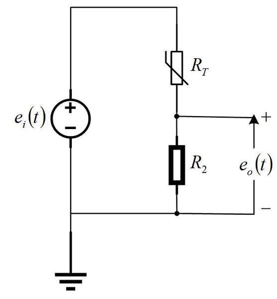

I want to measure temperature using an NTC3950 thermistor. My circuit diagram is as follows:
52602050_2283098551974676_3639846829010452480_n.jpg?_nc_cat=104&_nc_ht=scontent.fntr6-2.jpg
It's basically a voltage divider. By varying the temperature acting upon the thermistor the output voltage will change as well.
