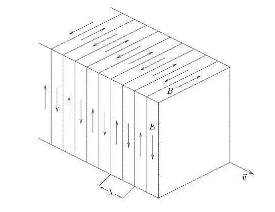

Yes, I know the graph. You find it in almost every EM textbook. It is, of course, correct, but I found it misleading to most of my students.
So I did another drawing of an electromagnetic plane wave (a wave that comes from far away). Imagine a rectangular chunk of space, chopped in slices as an "American sandwich bread".
In the first slice drawn, the electric field E is vertical and downward and the magnetic field B is horizontal and directed to the right. This is so in all the volume of the slice (the drawing displays just a "square" of the slice which is very much large.
The amplitude of both fields are maximum in middle of the slice (between the two faces) and decreases as a sinusoid to attain zero just at the faces of the slice.
The situation is identical for each other one slice. In the slices in-between the direction of both fields is just reversed.
Now, all the slices move at the speed of light v (or c if it is in vacuum) as the arrow indicates.
The thickness of two slices is the wavelength of the wave.
The real dimensions of the slices depend on the wavelength. For AM radio waves you would be a microscopic spot in the drawing. But, if the EM waves are light, it is the drawing which would be a microscopic spot in your pupil.
Think about this drawing. If you "see" it, then you will be able to understand the other one and realize that, of course, it is also correct.

I saw one that looked like a sine curve I mean, each time it completed a 900 period (clarify my wave terminology) it would go to the z-axis which is the magnetic field. Another 900 later it would go back to the y-axis which is the electric field.
And because it was a sine curve, as x was increasing, the amplitude also changed hence a changing electric led then changing magnetic field and vice versa that's how I perceived it.
I think the last 2 posts by f3nr15 are explained by his misinterpretation of what he was looking at. I suspect he thinks it is just one graph he's looking at wherase it is two that are superimposed using the same set of coordinates. One for the electric field and another for the magnetic field. It is always dificult to convey 3 dimensional information in a 2D drawing, and I think this has produced the confusion in the present situation.

In an EM wave, the variations in time of electric field create magnetic field and the variations in time of magnetic field create electric field.
Understanding the graphs and making a mental idea of what is an EM wave asks for reflection and mental endeavor. And it is you who must do it. No one can think on your behalf. Think again about the two graphs.
