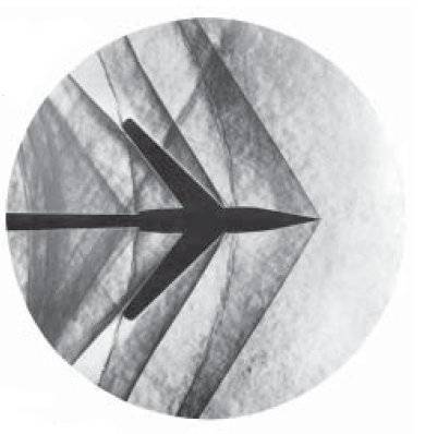

Drakkith said:
The plane is flying faster than sound so the air literally cannot get out of the way fast enough and ends up being accelerated and compressed, forming a shock wave.
This photo make Drakkith's words seem graphic.
But photos like this make me wonder about the shock wave rapidly slowing to sonic speed. If it did so, I think the trailing front would be parabolic, not straight lines. Every photo I've seen shows the shock wave front propagating as a straight line until it intercepts the ground.

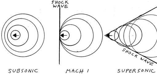

This drawing also helps.
From wiki:https://en.wikipedia.org/wiki/Shock_wave#In_supersonic_flows
Shock waves are not conventional sound waves; a shock wave takes the form of a very sharp change in the gas properties. Shock waves in air are heard as a loud "crack" or "snap" noise. Over longer distances, a shock wave can change from a nonlinear wave into a linear wave, degenerating into a conventional sound wave as it heats the air and loses energy. The sound wave is heard as the familiar "thud" or "thump" of a sonic boom, commonly created by the supersonic flight of aircraft.
From your picture, it looks like the overlapping of many different sound waves creates the straight lines. This would mean that the line is not a shock wave, it is just the constructive interference of many different sound waves created by the dissipating shock wave over time.
Consider the following. As a plane travels past mach 1, the sound waves generated by the plane can no longer propagate forwards faster than the plane. So each moment in time a new sound wave is created ahead of the existing wavefronts. Each new sound wave would then overlap and interfere with the existing sound waves and create a new wavefront that travels outwards from the source. Since the source is moving, this wavefront takes the shape of a cone. And what does the point of the cone look like as a 2d shape? A triangle with straight sides.
In other words, while a sound wave is circular in shape (spherical), the outermost edge of the overlapping pattern of many soundwaves created by an object traveling faster than sound in a medium is a straight line (aka a cone, not a sphere).
