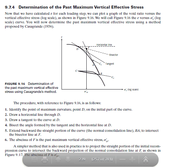

Urgent!How to find the point where Maximum Curvature occurs on graph?
The graph(2D) is plotted from experimental data, not from a given equation and within certain limit. I want to know the x&y coordinate where the maximum curvature occur via software means, not manually. FYI, for those with civil&geotechnical engineering background, the graph i am plotting is about consolidation topic of soil mechanics subject, which is the void ratio vs effective stress curve. I want to get the preconsolidation value from the graph plotted.
p.s. the attached file is rough idea of what i mean.
From the tone of this, I suspect that you are to determine the point of maximum curvature by looking at the graph and deciding where it appears to "curve" most!
yes, do u know any software that can find the point?
lol,no offense i aint that advanced to get the maximum curvature by hand calculation, lol, that's why i need a software, if not, imma get the point via naked point instead
