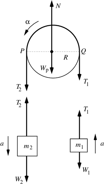

Let’s say we have a pulley with some box attached to it, mass of the box is ##m##. We consider rope to be massless and inextensible and pulley to have mass but be frictionless. How can tension apply torque on pulley?

In high school textbook I’m using (and also the other high school textbooks), it’s said that tension applies torque. Take for an example this diagram I found on the internet:
T is tension in that diagram. If the pulley is frictionless (in either of the ways that I asked you about), then any torque on the pulley is zero and can be neglected in the problem to be solved.

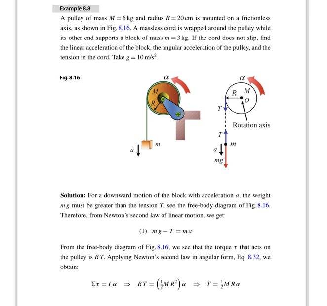

This is what seems logical to me but when dealing with high school problems, I am constantly hitting my head against the wall. Things seem to make no sense to me quite often, like in this example. I don’t know if it’s just me but I feel like the only way to learn this level of physics is just to memorize until you reach college to be able to actually understand it.
I am wondering how can something like this I found in textbook be true?
You still have not posted the whole problem statement so we can try to help you with your misunderstandings. Please post the whole problem statement and show your best efforts to start working on the problem. That's how things work here at PF, and how you should always approach your schoolwork problems. Thank you.

The situation described comes close to real life, so maybe you can just try to apply it to real life? In real life, the friction between a pulley and rope is much more than the friction between the pulley and shaft. So the pulley rotates at the same rate as the rope pulls it.

Yes according to solution there’s no slipping. But friction isn’t mentioned anywhere so it confuses me. In real life, friction between pulley and the rope must result in net torque. But if the pulley and rope were somehow frictionless, wouldn’t the rope just slide even though pulley isn’t massless?

The key words in the problem posted above are "frictionless axis" and "does not slip". As @Lnewqban suspected, the pulley is frictionless at its axle. But not where the rope rides over it.

This is quite intuitive to be honest, but why is friction not taken into account in equations then? That’s exactly what I’m trying to figure out right now

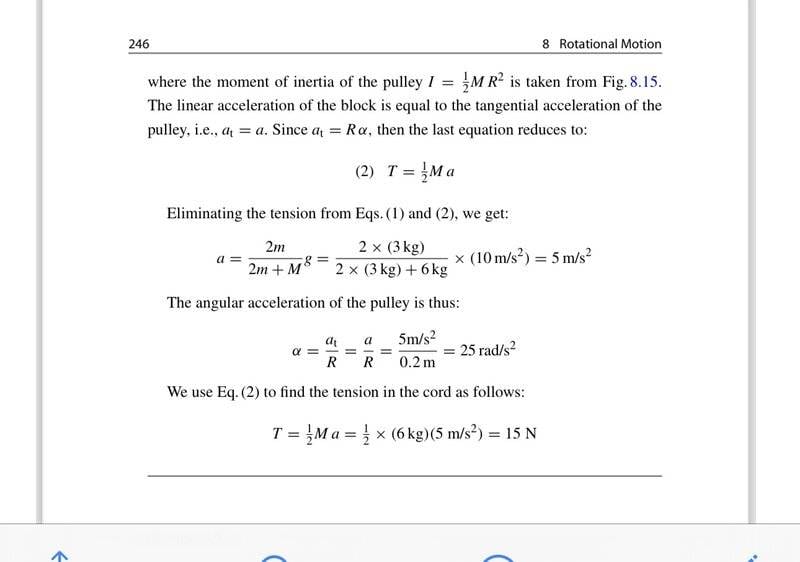

It is static friction without slipping. That means that the force of friction will be whatever it has to be so that the rope does not slip. That is a constraint. A constraint that allows us to write down an equation relating the acceleration of the pulley to the acceleration of the falling weight.
It is a massless rope. That means that Newton's second law tells us that the force from tension in one direction must match the force from friction in the other. There is no need to even mention the force of friction since it will obviously be equal to the force from tension. One can plug the tension directly into the equations and solve.

Thanks for help!
