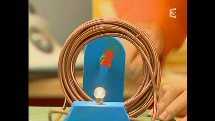

Here is a rotating magnet inside some coil tubes:
I recently learned about Faraday's law. Here since the bulb lights, there must be a changing magnetic flux inducing a current throught the bulb.
Where is the magnetic flux changing? To me, the magnetic field does not change throught the whole circular area enclosed by the big loops.
However, if the loops are empty tubes, then yes, there is a changing magnetic flux throught the area enclosed by each small cross section of each tube. BUT shouldn't the currents profuced then be running along the small cross sections circumferences of each tube, rather than along the length of the tubes? But if the bulb lights, the induced current must go along the length of the tubes!
So my questions are basically : where is the magnetic flux is changing and in what direction goes the induced current in the above picture?
The induced voltage/emk(1 must be directed along the tube, and the flux must change through an area, surrounded by the coil.
I see some magnet spinning in the background, but cannot see the angle of the plane it's spinning in, neither the angle of the plane, that the tube is coiled in.
(1: Faraday says that an emk is induced, not a current. The current comes from: I = V / R.

The image is from a video. It's hard to tell but I think the magnet is spinning in the center of the coiled tube. And in the same plane.
But how can magnetic flux throught the area surrounded by the coil change? The quantity of magnetic field lines going in or out of the area is always the same here, no matter if their direction are rotated.

EDIT : I found a link to the video. It srarts at 12:28. It's in french though.
http://www.veoh.com/m/watch.php?v=v20854920EsD8ff9b
If you watch the video closely when he starts, the bulb oscillates between light and dark. A single loop might have the same effect: the loop is not completely closed at the bottom due to the connections to the light bulb.
Ah, interesting! Indeed there is a bottom loop going to the bulb, and in this loop the flux changes.
Would that mean that the other loops are totally useless?

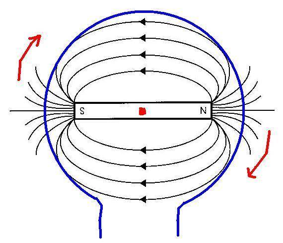

I don't think you are not visualising it correctly ... have a look at this drawing I did
blue is the wire loop
red is the rotation direction of the magnet about that centre red point, just as in the video you posted
under such conditions, I can visualise the loop being constantly subjected to a varying magnetic field

DoobleD said:
No angle between any line and the area changes
its changing constantly. rotate the magnet in my drawing step by step say at 45 deg steps and look at the changing angle between the field lines and the coil

Thank you for the drawing!
The magnetic field is rotating, but why is the flux affected by this rotation? According to Faraday's law, only the rate of change of the flux matters. There are 3 possibilities then: the field lines get closer or farther from the area, the angle between the lines and the area change, or the area changes.
Here, the lines move, but their angle does not seem to change, as well as their distance to the area. And the area is fixed. What varies then?

@davenn: the flux is not changing in that setup. The magnetic field at different places changes, yes, but there is no flux through the area because all field lines are parallel to it (=in the drawing plane, within the circular part of the loop). No flux also means no change in flux.
It could be related to the Faraday paradox, but there the geometry is different (there is a field orthogonal to a current which we don't have here).
Likes davenn and DoobleD
