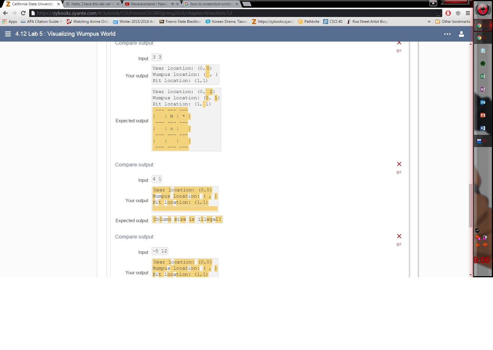

This is so far I have gotten to my code and I am stuck on how to create the grid.

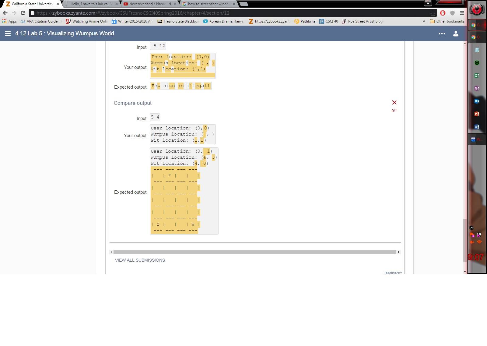

This is what I got after compile my code and run it :View attachment 5313View attachment 5314

So far I know that I need to use whitespace to fix my spacing but I am stuck on how to get the '*', 'W' , and 'o'. My lab instructor told me to use while loops; help guide me.
I've posted some working code below. Try to figure it out and (possibly) improve it.
