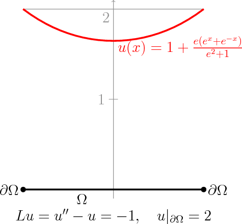

Hmm... suppose we pick... an example! (Wait)
I'm not sure if the solution $u=1$ is correct. (Worried)

Why was my argumentation with the minimum value wrong? (Thinking)Also can a function that is smaller or equal to $1$ be equal to $2$ at the boundary? (Sweating)
We assumed that u had a maximum where the derivative was zero. I think we have proven that there is no internal maximum when c=-1. Instead we have the sharper boundary maximum of 2! (Smile)

Yes. And we can apply neither here.
Instead we assumed there was an internal maximum, and found an upper boundary of $1$, which is a contradiction, since we have boundary values of $2$.
Therefore the assumption should be false: there is no internal maximum.
Shouldn't it? (Thinking)

Yes, it should. So from this we deduce that the maximum is achieved at the boundary, and so $u(x) \leq 2$, right? (Thinking)

We found that the internal minimum, if we have one for c=-1, has to be at least 1.
And indeed, in my example it's between 1 and 2. (Thinking)
