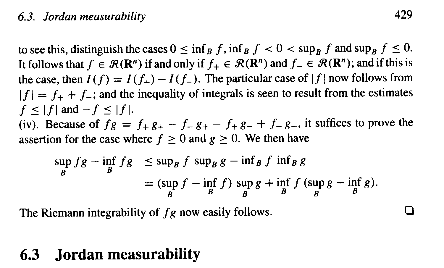

I am reading J. J. Duistermaat and J. A. C. Kolk: Multidimensional Analysis Vol.II Chapter 6: Integration ...

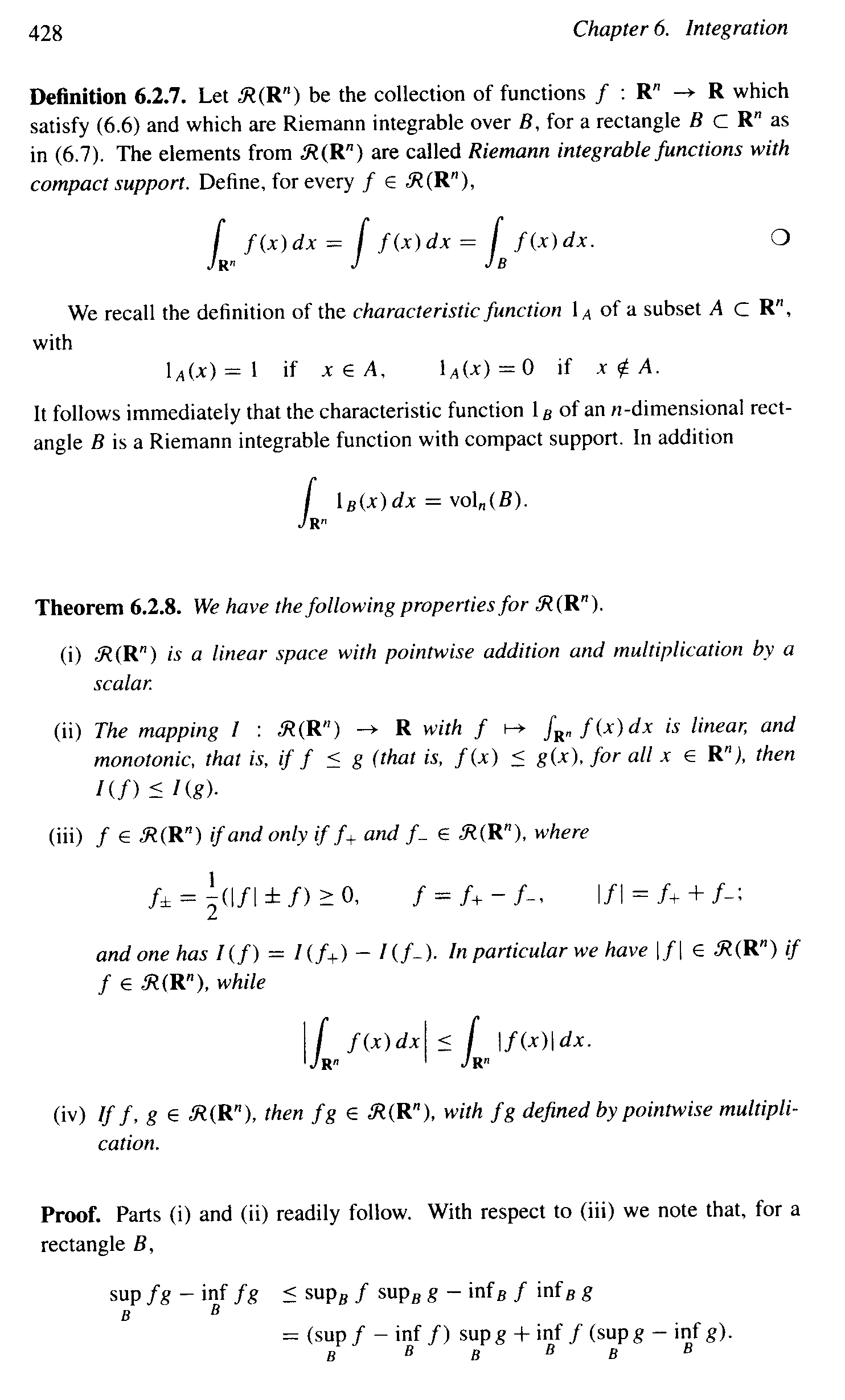

I need help with the proof of Theorem 6.2.8 Part (iii) ...The Definition of Riemann integrable functions with compact support and Theorem 6.2.8 and a brief indication of its proof reads as follows:

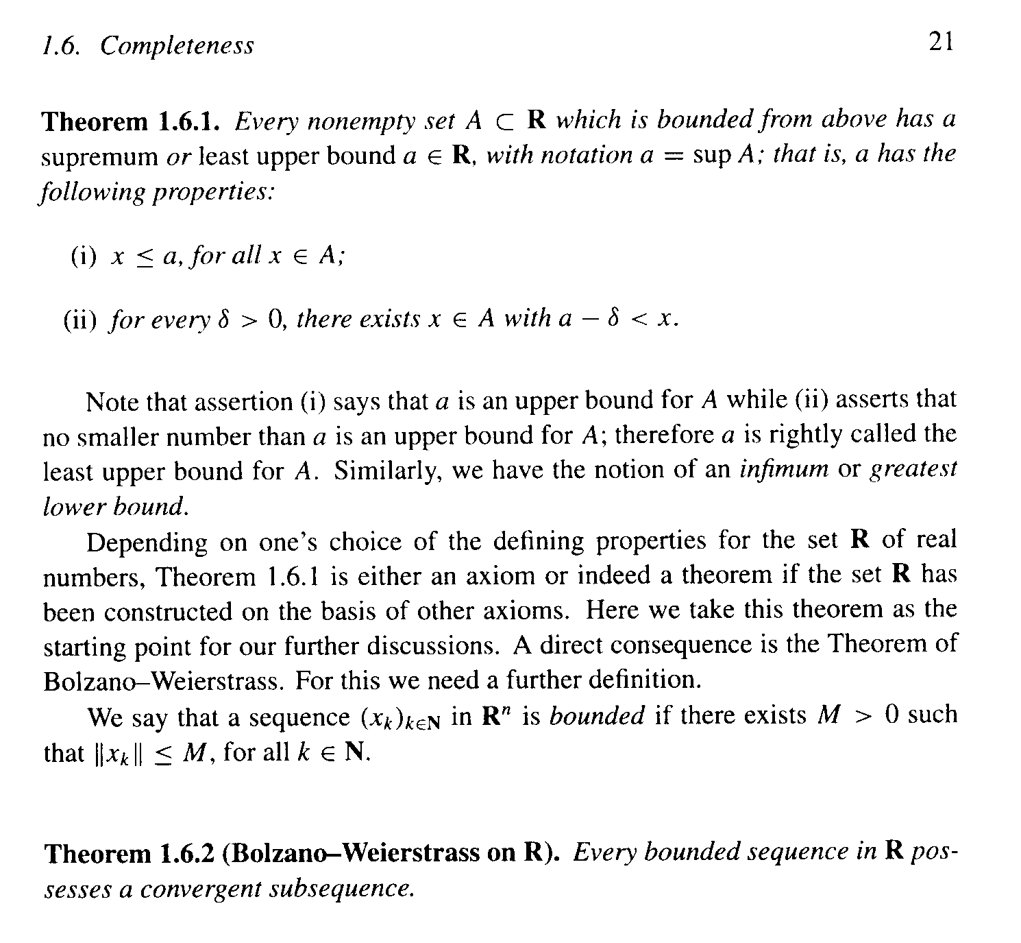

The definition of supremum and infimum are given in the following text from D&K Vol. I ...

I need help to formulate a detailed, formal and rigorous proof that \(\displaystyle \text{ sup}_B \ fg - \text{ inf}_B \ fg \leq \text{ sup}_B \ f \text{ sup}_B \ g \ - \ \text{ inf}_B \ f \text{ inf}_B \ g \)I have been unable to make a meaningful start on this proof ...Help will be much appreciated ...
Peter
For every $x\in B$, $f(x) \leqslant \sup_B f$ and $g(x) \leqslant \sup_B g$. Therefore $(fg)(x) = f(x)g(x) \leqslant \sup_B f \sup_B g$. Now take the sup over $B$ to get $\sup_B fg \leqslant \sup_B f \sup_B g$. A similar argument shows that $\inf_B fg \geqslant \inf_B f \inf_B g$ and so $-\inf_B fg \leqslant -\inf_B f \inf_B g$.
