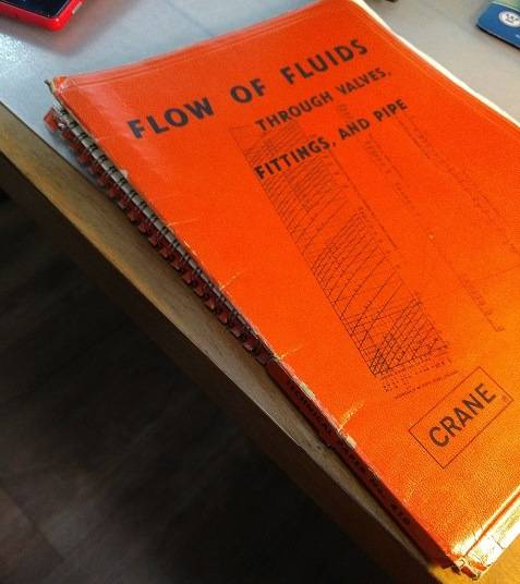

This is a wildly popular reference : "the Crane handbook"
240988
. Most mechanical engineers i know have a copy in their desk drawer. Surely your library has one.

Crane's tech report is definitely considered the bible of piping systems and provides the pressure differential between the inlet pressure and a downstream point in flowing piping system; however, the key element of the pressure at any point in a pipe (system) is what is downstream of that point that is causing the pressure. A pipe with no downstream restrictions will not have a static discharge pressure at its end. That is why a full system analysis is required.

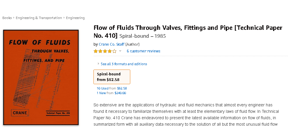

This copy was $8 new.
