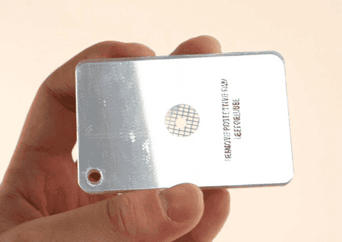

Here's an example even more dramatic than the ISS. A hand held signal mirror. The video shows it seen from 0.7, 11.1 and 43 miles away.
Likes russ_watters, phinds, dlgoff and 2 others

TruthSeeker777 said:
Thanks, that is only because its a convex mirror.
Check your facts. It looks pretty flat to me.
Likes malawi_glenn
Likes malawi_glenn
Thanks, that is only because its a convex mirror. Light spreads out when its reflects off a convext mirror. If the mirror was flat you wouldn't be able to see it beyond the angular resoolution limits? Pictures of the ISS don't seem to indicates concave surfaces from what I can see?
All my signal mirrors are flat. Any curve at all to them would defeat their operation. What is the basis for you claim that the video shows a convex signal mirror? Please cite your source on that.
It is not convex. It is flat.
A convex mirror would not appear as a single point of light over the large range of distances from 0.7 miles to 43 miles.
ah yes, you're right its not convex. Thanks.
CORRECTION - its not a convex mirror.
This is a good point. A mirror certainly reflects the vast majority of light from it. Is the suggestion that solar panels from the ISS are reflecting the vast majority of light that hits it from the sun? The solar panels I've seen do not seem to be very reflective and are grey in colour.

hutchphd said:
But the lack of convexity is one of the hallmarks of much of stealth design (look at the SR71!) . A flat surface will reflect a point source only over a very small range of angles. It makes it impossible to track. This is also why you must actively wobble the signal mirror.
The mirror can be flat because the Sun is over half a degree in diameter, which is greater than the angular resolution of your eye. With RADAR, the illumination angle is very much less.

Yes of course. But you still have to wobble your rescue mirror!
Why? Scratch a hole in the mirror, so you can look through at your outstretched arm thumb. Point your thumb at the target, then reflect the Sun onto your thumb. Problem solved.
So when the rescue plane flies over Is your thumb sight good to half a degree? Also you want the Flashy Wobble for contrast. I'll use the wobbly eyeball approach, thanks!. Actually I would do both...
It works well. Measure the size of your thumbnail against the Moon or the Sun. A steady, bright light is easier to see from a moving aircraft than momentary flashes. I try not to need it.
