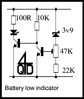

Hi,
I'm not sure if this is the right place to post this, but here goes.
I'm trying to build a battery indicator circuit for 2 AA batteries (3V). So far what I've read online is that I'd need to use a Zener diode to get a fixed voltage drop, then connect it to a transistor, like the diagram here:
http://www.4qdtec.com/batty.html"
Only problem is, the smallest Zener diode is 2.4V, so the difference between the base and the emitter would be very small - 0.6 V - even when the battery is fully charged.
Will this work?
If you don't get help here, try the Electrical Engineering forum. They should be able to help you there.
Are you looking at this schematic?
Typical diodes have a 0.6-0.7 V drop when forward biased, so you could use a few of those in series.
Yup I'm looking at that schematic, which is for a 6V battery.
Thanks Sciurus, I didn't think of that even though I have a few diodes lying around. So I guess instead of a Zener diode in reverse bias, I could just use (say 3) normal diodes in forward bias to get a 2.1V voltage drop, so the voltage difference between the base and the emitter is around 0.9 V when the battery is fully charged, and decreases as the battery is drained?
Or do I need a different circuit?

I would suggest considering a different circuit design that takes into account the limitations of the Zener diode. One potential solution could be to use a voltage divider circuit with resistors to create a reference voltage that is lower than the 3V battery voltage. This reference voltage can then be compared to the battery voltage using a comparator circuit to determine the battery level. This approach would not rely on the use of a Zener diode and would allow for a larger voltage difference between the base and emitter of the transistor. Additionally, using a microcontroller with an analog-to-digital converter could also be a more accurate and versatile solution for measuring the battery voltage. I would recommend researching different circuit designs and consulting with experts in the field before proceeding with your project.
