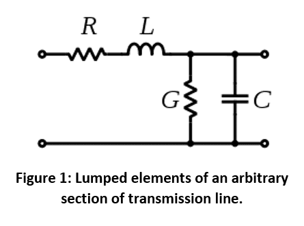

Perhaps this will help. The picture below shows the equivalent circuit we use in circuit analysis to represent a real physical piece of wire. The OP is wondering about the resistance of a real wire R. If he continues his studies, he'll eventually discover that the L, C, and G terms are also nonzero in real life.
So, we can use this equivalent circuit to represent every segment of real life wire. But then we use Circuit Analysis (CA) to solve the whole thing. And the CA presumes that all the components are idealized and divorced from the physics. CA is a very powerful calculation technique. It is not physics.
Please read the article before posting more questions.
