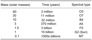

CALCULATIONS
https://en.wikipedia.org/wiki/Milky_Way
Total mass of stars : 100 billion sun-mass units
https://en.wikipedia.org/wiki/Stellar_classification
TYPE MASS FRACTION
O >=16 ~0.00003%
B 2.1 - 16 0.13%
A 1.4 - 1.8 0.6%
F 1.15 - 1.4 3%
G 0.8 - 1.4 7.6%
K 0.45 - 0.8 12.1%
M 0.48 - 0.45 76.45%
(My apologies for the chart being hard to read. I do not know how to format it better here.)
-> Average star mass ~0.56 sun-mass units
-> number of stars in Milky Way ~180 billion
